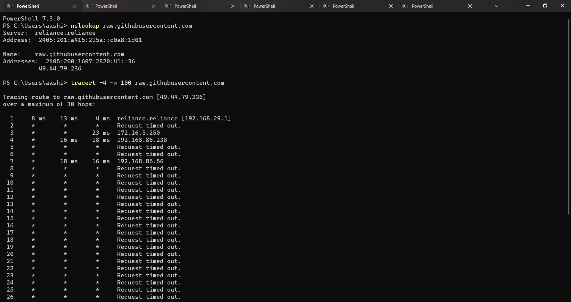

    Go find a friend and see if their PC resolves raw.githubusercontent.com to that IP address.
    Did you do that? Have someone on another PC in India do an "nslookup raw.githubusercontent.com". What IP do they see? Do they use the same ISP that you do?
    As for these addresses i have tried out in powershell 7.1 and 5.1
    This has nothing to do with any version of powershell. It is a networking issue.
    As for the Problem with ISP can you be more detailed on this part as i am quite new in this field.

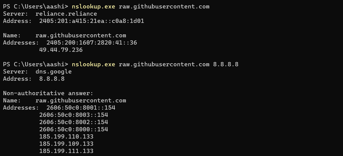

    The question is: why does raw.githubusercontent.com resolve to 49.44.79.236 on your pc?
    I used Nmap to analyze that IP and it found 2 open ports, 554 and 7070. HTTP and HTTPS are NOT open. That is not a web server. Nmap reports that it is probably a cable modem.

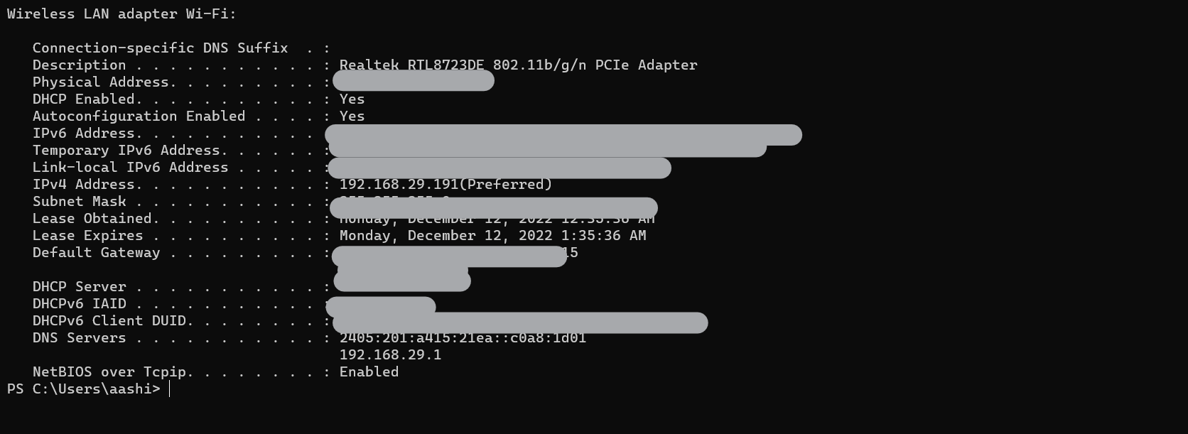

    My laptop is configured to use DHCP from my WIFI router. It serves as the DNS server to resolve local names on my network. Run "ipconfig /all" to see your pc's DNS servers. What are they?

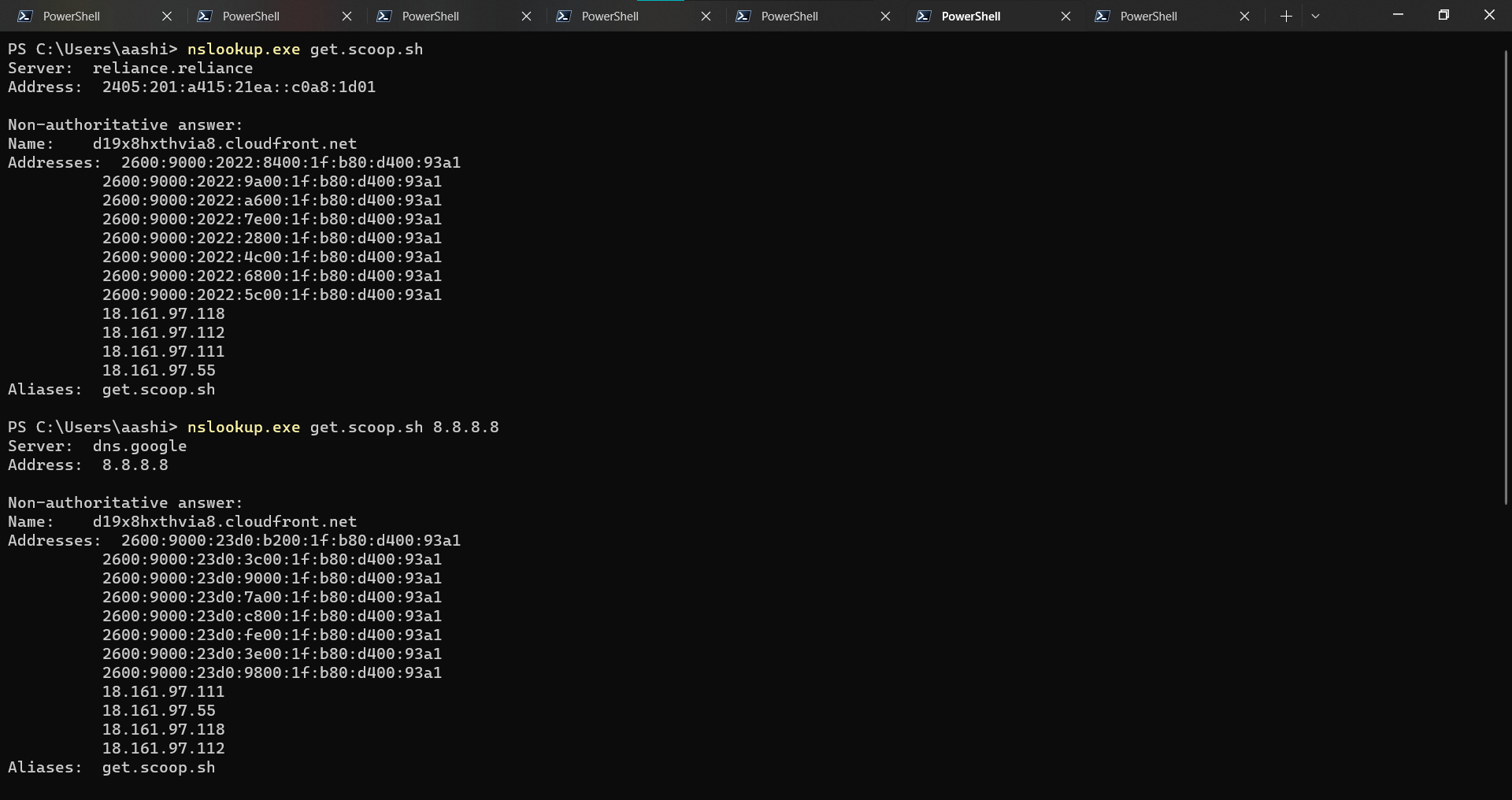

    Paste these commands into a command prompt window. It will query the currently configured DNS servers and also the Google DNS servers.
    nslookup.exe get.scoop.sh
    nslookup.exe get.scoop.sh 8.8.8.8
    nslookup.exe raw.githubusercontent.com
    nslookup.exe raw.githubusercontent.com 8.8.8.8
    If your pc uses your router for DNS you should see that in the "server".

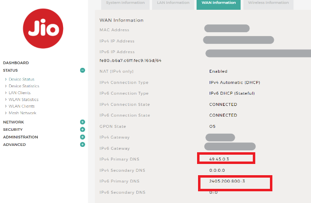

    In that case you would need to logon to your router and see what DNS servers it is configured for. Here is what mine looks like.
    What address is your router using?
    My Verizon DNS server resolves the names correctly.
    One option you have is to set your NIC or your router to use Google's 8.8.8.8 DNS server.

  1. aashish kumar 26 Reputation points
    2022-12-11T20:27:14.477+00:00
    Hey @MotoX80 thanks for reaching out to me and sorry for delay

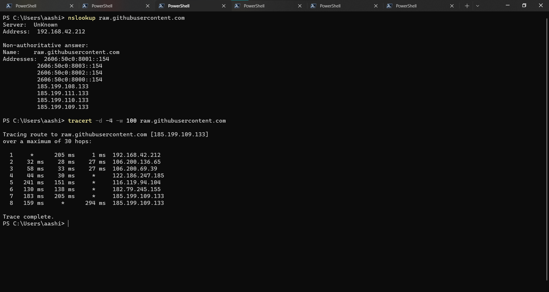

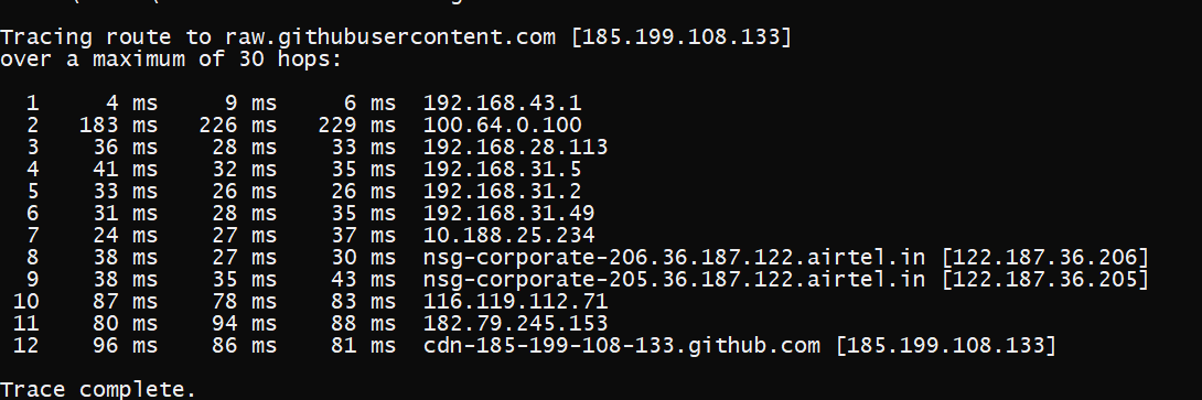

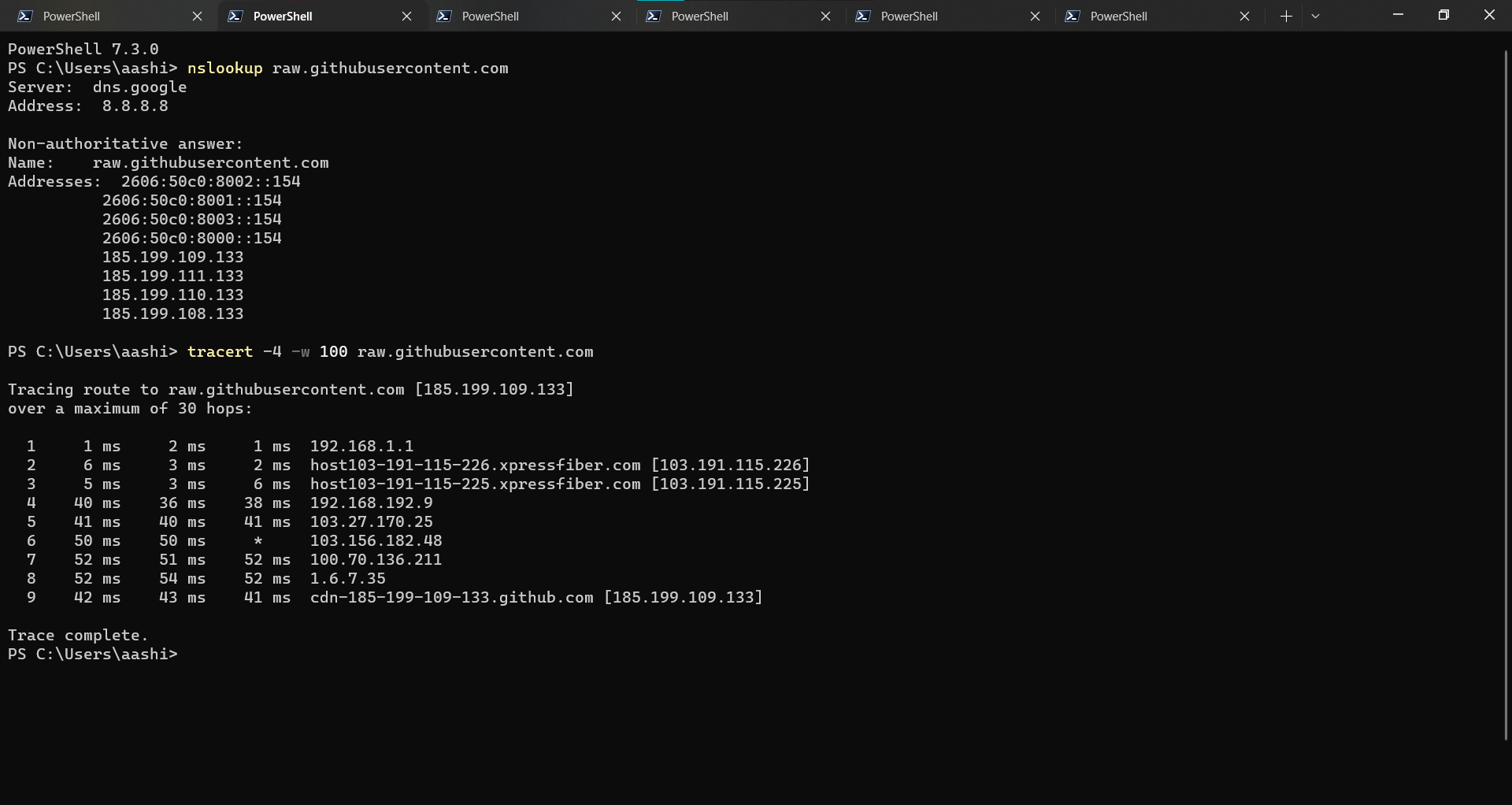

    yes, I tried it in my friends Pc and here are the results
    NOTE: (up ahead) Following Tests are performed on my computer using different routers
    my friend-1 router with same ISP
    my friend-2 router with different ISP
    Using Hostspot thetring (different ISP)
    here are the results:
    I use Reliance Jio (My ISP) with public IP 49.37.67.251
    i logged in and checked here it shows:

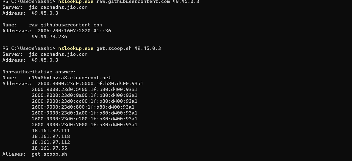

    I tried to test again using my routers dns, here is what i got
    Seeing all these results i concluded that may be its the problem with my ISP and not with router or anything so i tried to connect to vpn and it worked smoothly with no errors using my router and then i came across a subreddit discussion which stated like my Isp has blocked raw.githubusercontent.com , i don't know why they decided to do so but it seems the case.

    This site: https://www.intodns.com/jio.com says that the Jio DNS servers are these:
    ns1.jio.com. ['49.40.1.65'] [TTL=172800]
    ns2.jio.com. ['49.40.1.66'] [TTL=172800]
    ns3.jio.com. ['49.45.0.84'] [TTL=172800]
    ns4.jio.com. ['49.45.0.212'] [TTL=172800]
    Try using those dns servers and see if the name resolves to the correct IP.
    nslookup raw.githubusercontent.com 49.40.1.65
    If it does, then contact Jio support and ask them why jio-cachedns.jio.com and ns1.jio.com return different addresses.
    If 49.40.1.65 works, Then change the DNS settings on your router to that IP. You may also have to remove the IPV6 dns address. You would have to test that. You could also use Google's 8.8.8.8 address these.
