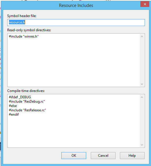

  1. RLWA32 49,551 Reputation points
    2020-10-01T14:31:16.607+00:00
    To include entire .rc files based on debug or release you can try this -
    Add the separate .rc files for debug and release versions to the dll project and configure their properties to exclude them from both release and debug builds.
    In the dll projects main .rc add compile time preprocessor directives to #include either the debug .rc file or the release .rc file. See how-to-include-resources-at-compile-time

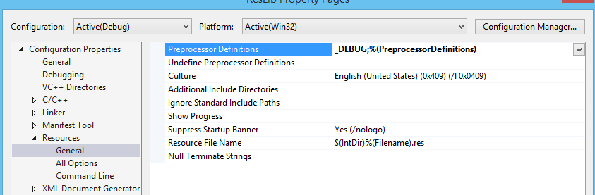

    In the dll project properties go to the properties for the resource compiler and add _DEBUG
