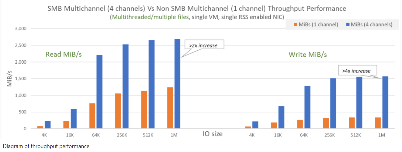

    You might see slow performance when you try to transfer files to the Azure File service.
    If you don't have a specific minimum I/O size requirement, we recommend that you use 1 MiB as the I/O size for optimal performance.
    If you know the final size of a file that you are extending with writes, and your software doesn't have compatibility problems when the unwritten tail on the file contains zeros, then set the file size in advance instead of making every write an extending write.
    This article lists some common problems related to Azure file shares. It provides potential causes and workarounds for when you encounter these problems.
    For testing purpose can you use Azcopy tools and check the speed and let me know the status. For transferring Files I would recommend to use AzCopy and File Storage for any transfer files(upload and download). In Azcopy throughput from a single instance will scale at least 20Gbps
    Additional information: Sometimes your proxies/VMs or whatever runs in the same datacenter, network requests does not leave the local network and the speed then depends on the infrastructure. (routers, firewalls, cables, etc). I'm sure they won't limit speed between their own infrastructure so services hosted on the same network works at full speed.
    Note: Windows OS/Windows Explorer is configured by default, it uses a 4K block size that will produce slower speeds for SMB compared to AzCopy/Storage Explorer which uses REST API.
