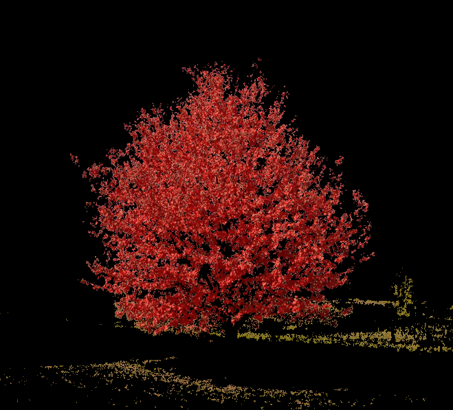

I am trying to code a Red Pass filer in C#. I might not be using the correct name for this, but I want to convert all the non-red pixel to black (0,0,0).
So, like how a high pass filter sets all frequencies below a giving setpoint to 0. I want to set all the non-red pixel to (0,0,0) aka Black.
My problem is that I am using images from a camera, so the red pixels are not (255,0,0) plus because of Light and shades on the object I am taking a picture of some of the red pixels are darker than others. Meaning this [Red Color] (https://i.stack.imgur.com/Hc42q.png) and this Red Color are on the same object in the image.
This is what I have Tried so for:
