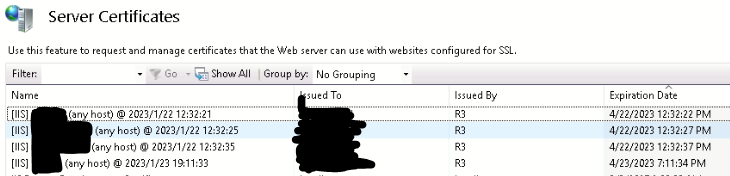

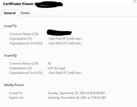

Hello,
I am using a Windows server 2019 with IIS and active websites, for some reason when i enter a website that exits in our IIS with HTTPS with valid R3 certificate from our server it loads an expired certificate ( i have tried Chrome Edge and Mozilla to test this). I entered me certificate manager using MMC and i cant find this certificate anywhere on the server, i reinstalled all the browsers i even removed the new certificate that was granted to the website and created a new one but still the same error. This problem occurs only in the server and not on any other computer. What could be the problem?

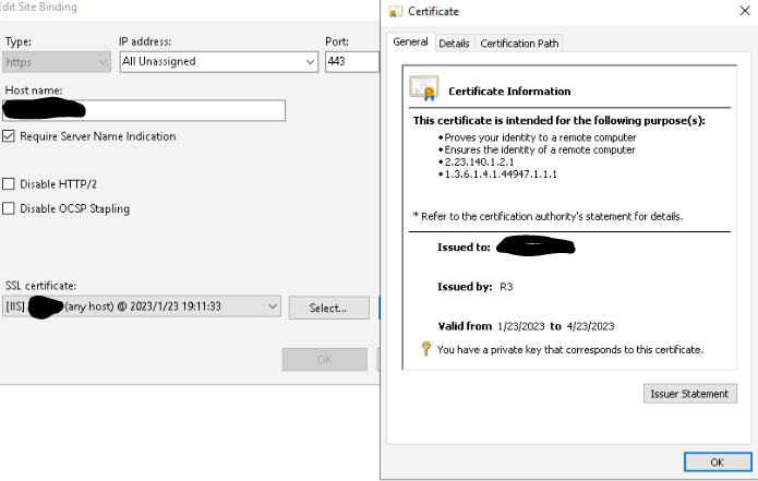

  1. Thameur-BOURBITA 36,261 Reputation points Moderator
    2023-01-24T00:52:11.3966667+00:00
    It seems that the expired certificate still selected in IIS setting. You can refer to article below to check which certificate is used for https binding:
    How to Set Up SSL on IIS 7
    Adding HTTPS Binding

  4. alex hental 0 Reputation points
    2023-01-27T07:11:02.96+00:00
    I found the problem, i have two servers (one production and and the second is a hot standby) when i entered the website the request went to the standby server where the certificate was old (only renewed in case of a crash) and not the to the server itself, i just shutdown the iis service at the standby.
