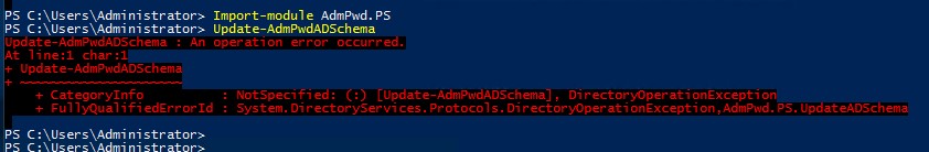

I attempted to install LAPS on my domain server, but ran into the following problem. The user I'm using is already a full admin, yet I keep getting the same issue. Please help.

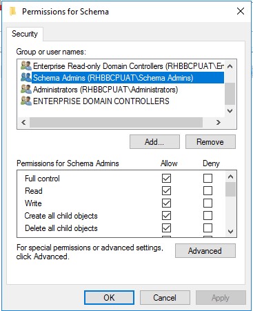

    The error "Update-AdmPwdADSchema: An operation error occurred" when running the "Update-AdmPwdADSchema" cmdlet in Microsoft Active Directory might indicate a problem with the Active Directory Schema or with the permissions of the account that is running the cmdlet.
    Here are a few steps you can try to resolve the issue:

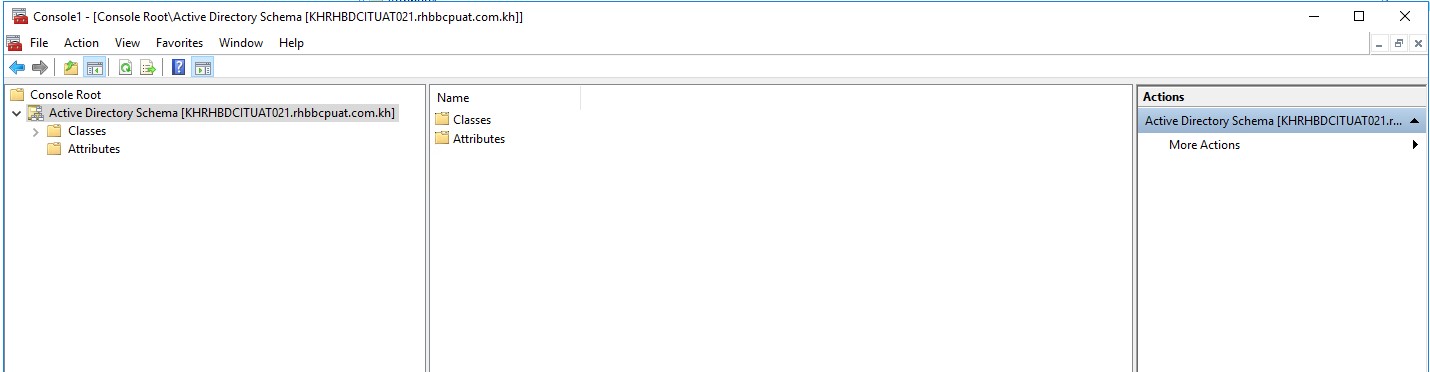

    1. Check the Schema Master Role: The Schema Master role should be held by only one domain controller in the forest. Ensure that the domain controller you are running the cmdlet on is the Schema Master.
    2. Check the Account Permissions: The account running the cmdlet must be a member of the "Schema Admins" group and a local administrator on the target domain controller. Ensure that the account has the required permissions.
