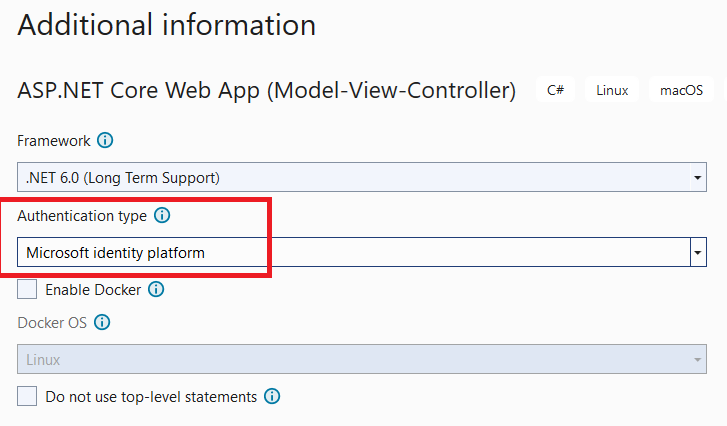

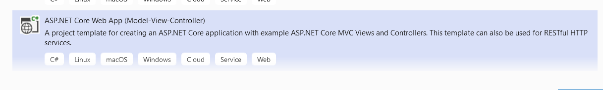

I created a new ASP.NET Core MVC 6.0 web application >> and i define it to use Azure AD for authentication, as follow:-
enter image description here

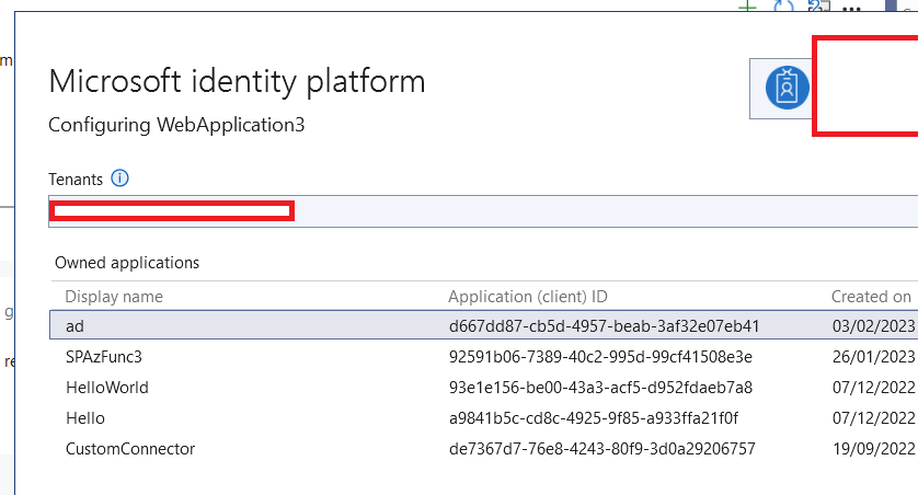

then i were asked to create owned application, so i created one named "ad" as follow:-

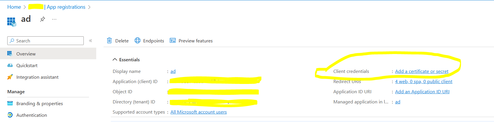

so seems visual studio did all the work for us. but when i accessed the "ad" application inside Azure >> i got that this application does not have any client credentials, so is this fine, as follow:-
Second question, if i want to define credentials, seems i have 2 options; create a client secret or certificate. so what are the differences between them? and if we add a client credentials then do we need to update our asp.net application accordingly ?

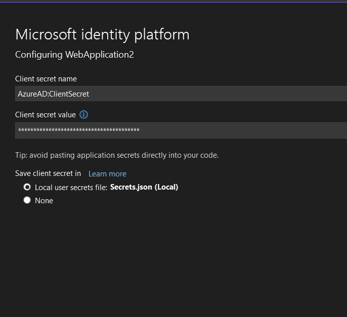

    However, Visual studio also provide the screen to configure the client secret as below :
    which will automatically add the secret in the portal.

  2. Bruce (SqlWork.com) 78,086 Reputation points Volunteer Moderator
    2023-02-06T16:27:16.8866667+00:00
    if the app just wants to authenticate the user, or just use the users access token, then the app does not need any credentials. but if the app want to make any api calls as itself, then it needs to prove who it is. you can use a secret, which is like a password or use a certificate. you will then update the application code to use the secret or certificate when it calls azure ad to get a an access token for the desired api.
    common case where the app needs its own credentials is using services like a database, or azure key vault, etc.
