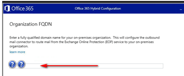

We have published EWS and SMTP on two separate pairs of Exchange 2016 mailbox servers (2 Public IPs) and using a single SAN certificate with the subject name mail.domain.com and autodiscover and SMTP FQDNs in SAN. Looking to deploy classic full hybrid.
EWS: mail.domain.com Public IP1
SMTP: smtp.domain.com Public IP2
While running HCW, what should we enter in the Organization FQDN? Is this EWS FQDN or the SMTP FQDN?
Screenshot 2023-02-06 020933
Thanks

    Thats for SMTP. By the way, there is no need to seperate them out.
    I would recommend using the same endpoint (mail.domain.com) for both EWS and SMTP.

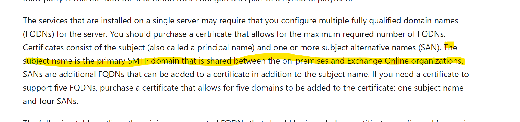

    Thank you. This is the security requirement to split EWS and SMTP. I would prefer the same as you mentioned. Is the SMTP fqdn in SAN of the cert fine or is it required to be in subject name?

    Based on your comment, is the below process correct? Appreciate it if you can glance through and advise.
    SSL Cert:
    Subject: domain.com
    SAN: mail.domain.com, autodiscover.domain.com, smtp.domain.com
    My assumption here is that HCW will do the autodiscovery by itself to discover mail.domain.com FQDN. We just pick separate servers for SMTP and cert and use smtp.domain.com when it prompts for the Organization FQDN. We don't need to mention mail.domain.com at any stage during the HCW setup.
    The reason why I am running through this process is to ensure that the HCW will set this environment correctly, especially the other things it does such as shared domain name space, federation, Modern Auth etc. I am wondering if I need to use mail.domain.com with HCW and change the smart host on the O365 once it runs or follow the above.
    Which one will be the right approach?
    Pl. advise.
