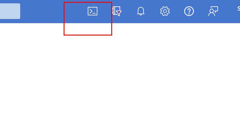

    I request you please open Azure CLI and try below commands with your server details:

    Please try above steps in Azure CLI and let us know if you are facing issue. We can further investigate this issue if CLI does not help.User's image
