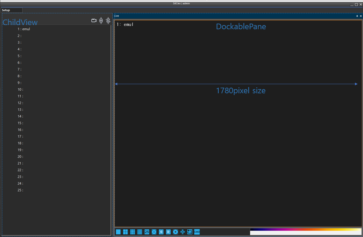

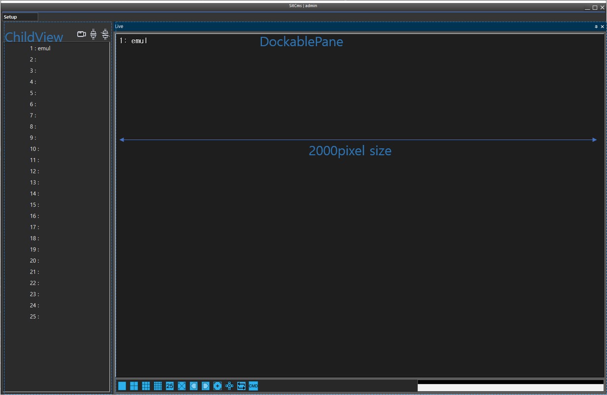

Hello, I am making software using the Cdockablepane of MFC.
But there's one problem.
If the Cdockablepane attached to the Mainfrm is more than 1780 pixels horizontally, the size returns to 1780 when it is shut down and restarted.
Strangely, the Cdockablepane floating outside MainFrm returns to its original size when it restarts, even if the horizontal size is larger than 1780 pixels.
Please help me with my poor skills.
please, refer to below captured pictures.
[Before shutdown]
before_shutdown
[After restarted]
