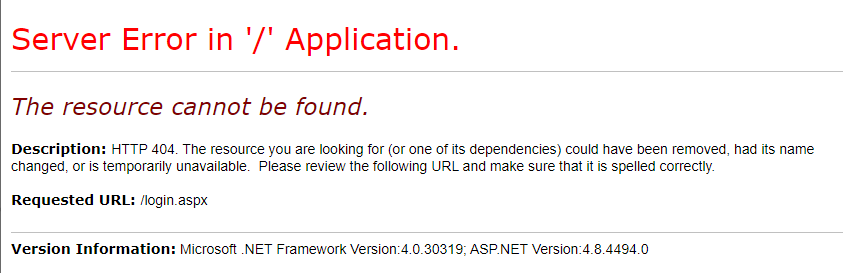

Background: I have old legacy ASP.NET MVC on premise application running on local windows IIS. I'm investigating ways to integrate this application with Azure AD authentication. As far as I can understand (Windows IIS integration with Azure AD) it's not possible to do it directly because of the Azure AD authentication can be added at the application level only. So I'm thinking integrating one of the MSAL library for adding Azure AD authentication.
Using this windows manual (Quickstart: Add sign-in with Microsoft to a web app), I've downloaded sample windows application (ASP.NET code sample) from this learn page and tried to run it within the Visual Studio 2022 in debug mode on my azure virtual work machine (based on VDI platform).
And Azure AD authentication does not work. When I click "Sign in with windows" button on the start application page, I get the error:
MicrosoftTeams-image (4)
This sample works fine on my local laptop in exactly the same state. I suggest that any security utilities might be the reason, but I don't know how to check it. I can't disable security apps on my working machine, and maybe there are any restrictions on the network level I don't even know nothing about.
Could somebody suggest any ways to solve this problem? Or maybe still ways to find the reason of this problem?

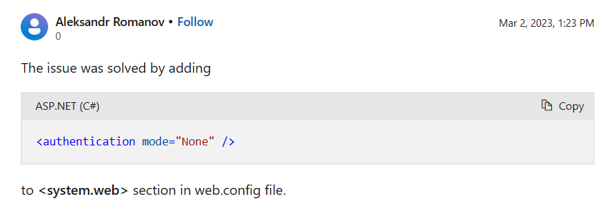

  2. Aleksandr Romanov 0 Reputation points
    2023-03-02T07:53:25.07+00:00
    The issue was solved by adding
    <authentication mode="None" />
    to <system.web> section in web.config file.
    The solution was found here
