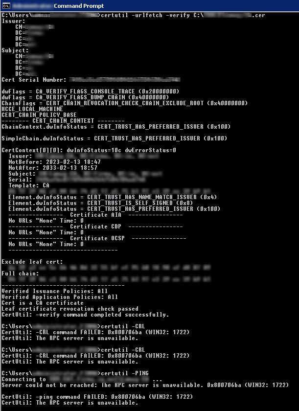

certutil -urlfetch -verify
shows:
verify

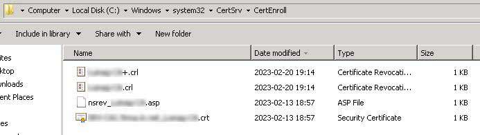

The CertEnroll folder contains the correct files. CRL valid until tomorrow:
CerEnroll

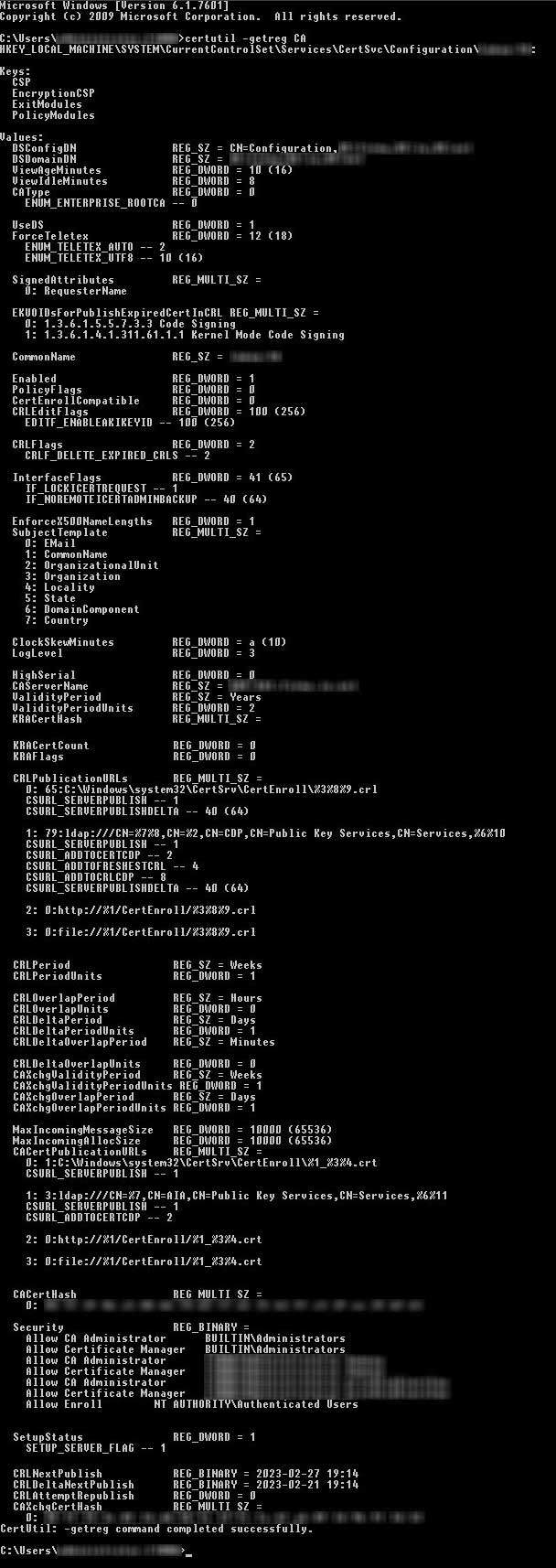

    2. Check the CA registry settings: Verify that the CA registry settings are correct by running the following command in an elevated Command Prompt:
    certutil -getreg CA
    This will display the registry settings for the CA.

    I'm not a CA specialist but there doesn't seem to be anything alarming here, right?reg_smthng
