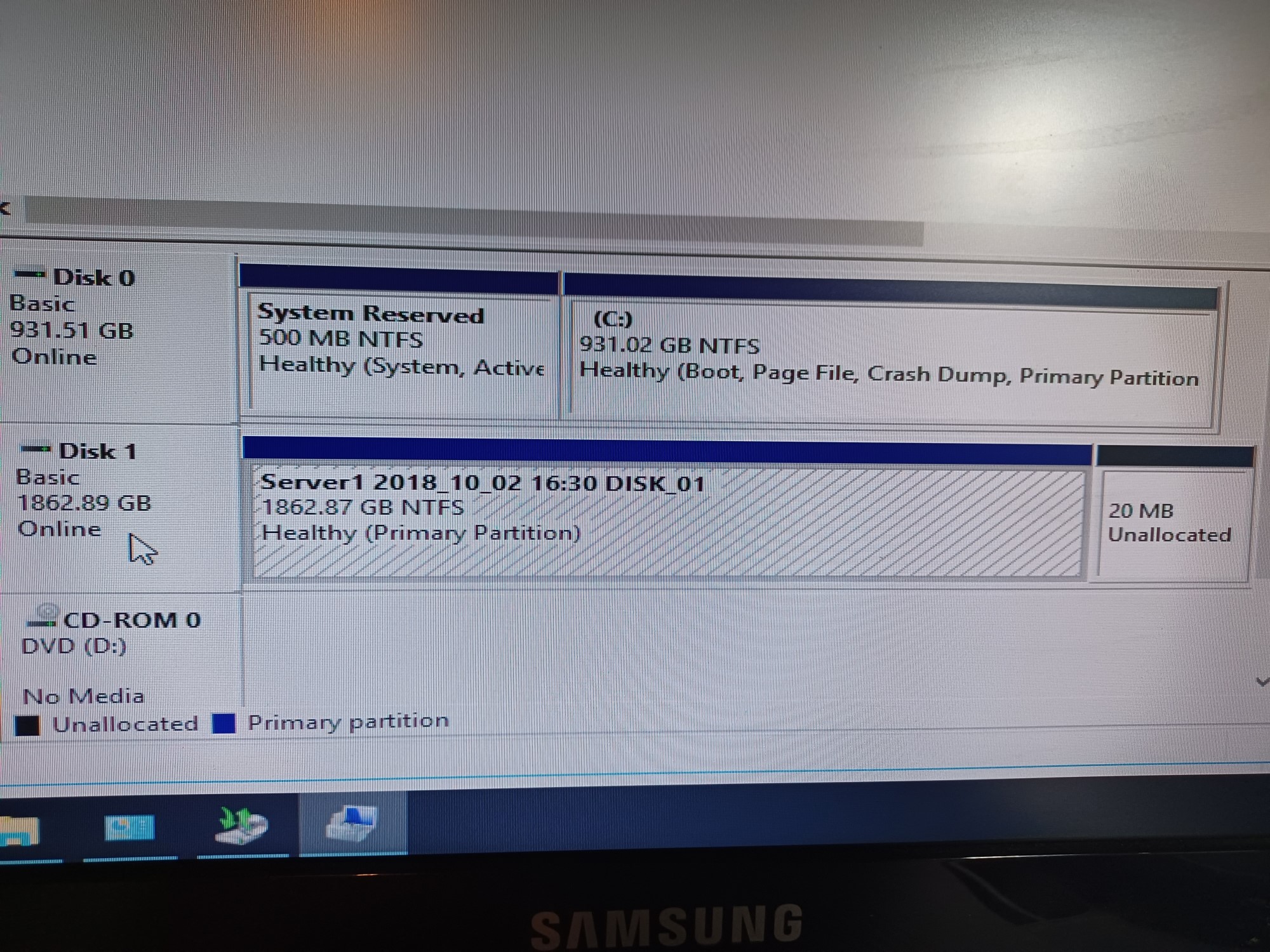

  1. Cale 20 Reputation points
    2023-03-01T21:00:44.2566667+00:00
    20230301
    Image is from the second server. I loaded server 16 connected my USB backup drive and gave it a letter before it could be seen by the command prompt. I also had to remove the volumes the GUI restore wizard added to the system drives.
