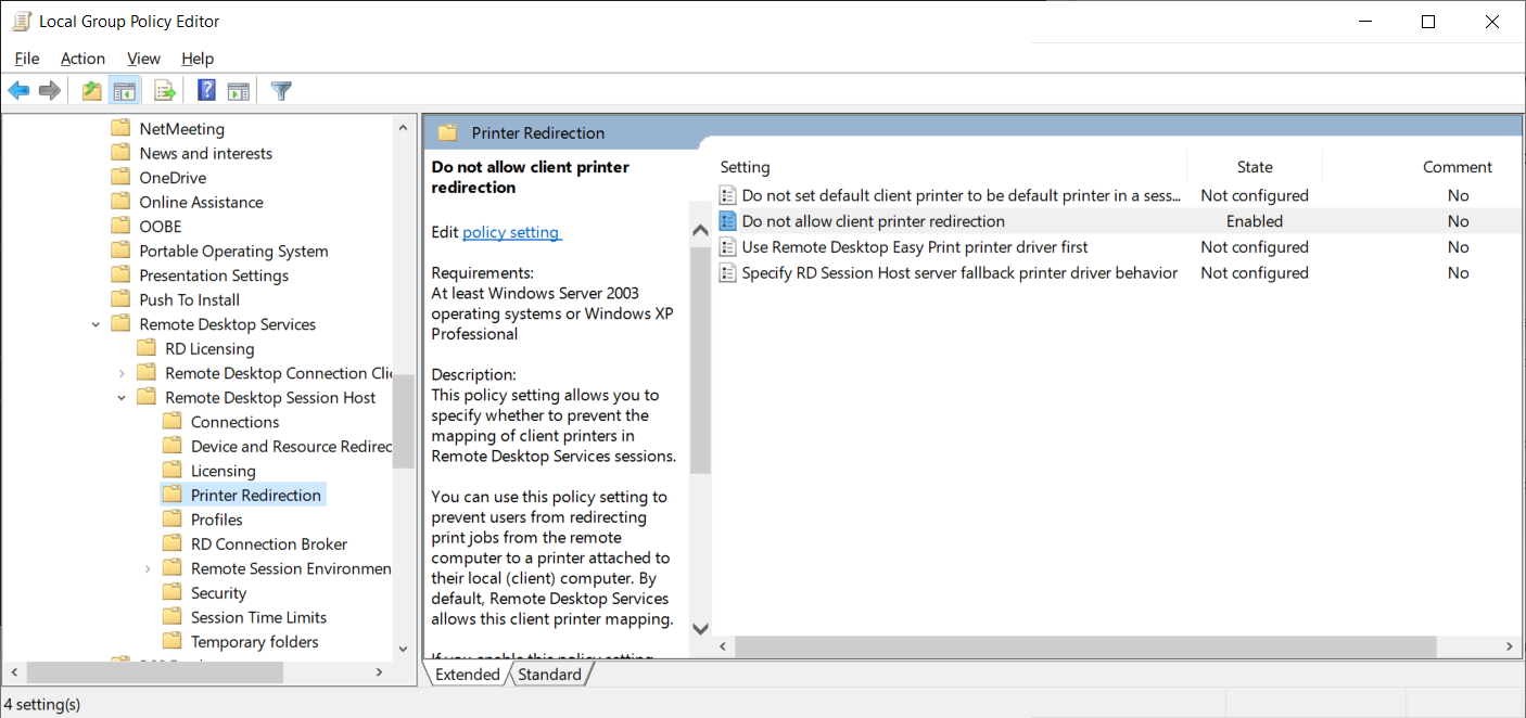

    For a print server, I always Enable the policy to block printer redirection.
    It is a best practice for print servers but may be on this machine that is not a print server, someone did enable the policy
    Computer / Admin templates / Windows Components
    The policy to turn off printer redirection is not enabled by default.
    Check the Windows Application logs during the log on. I think RDS logs to that event channel.

    Good Morning, do not allow client printer redirection is "not configured". Should I set it to "disabled"?

    Hi @Neil Taylor not configured is disabled. You are good there and getting the redirected printers. Were any of the other default settings changed for RDS printers. The MS Remote Desktop EasyPrint driver should be in use for the printer. It's a driver I have never trusted, because I opened bugs when I could make it crash that the TS team didn't want to address, so I typically delete it off my print servers. They might have fixed the bugs but as I previously stated, I turn the feature off in my environment. Have you installed the same HP driver on the server you are remoting to? The name must match between client and server. The redirected printer can't be added without a driver. The default is to set up the redirected printer using the Easy Print driver. I don't trust it. Install the actual driver for printer on the server. I would then log off from the session, then log back in. If the printer is failing, I do expect RDS event logs. Event 1111 was the event when the driver is missing so the printer can't be redirected. Thanks
