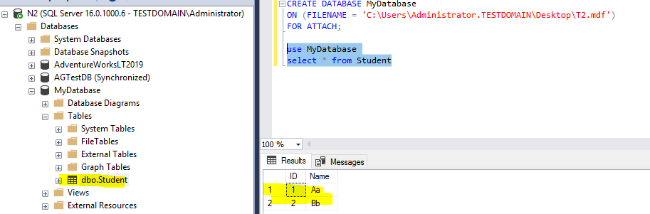

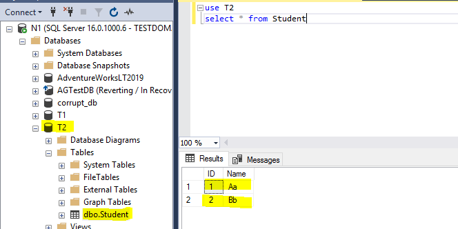

    On the first server, I created the database named T2 and created a table then inserted two records. Then I copied the .mdf file of this database to another server to simulate your situation.
    On the second server, the following T-SQL statement creates a database named MyDatabase and attach the data file from first server to here.
    CREATE DATABASE MyDatabase
    ON (FILENAME = 'C:\Users\Administrator.TESTDOMAIN\Desktop\T2.mdf')
    FOR ATTACH;

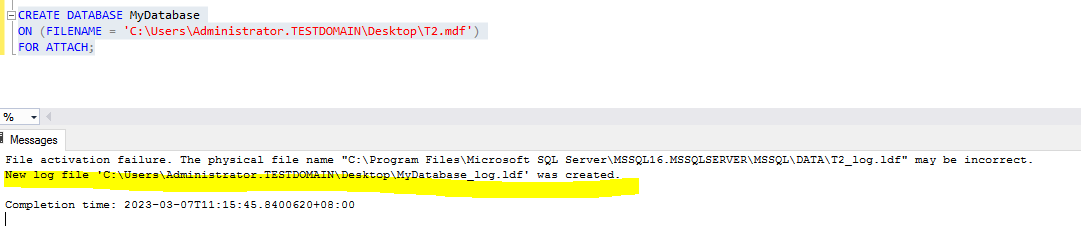

    This is because you didn't have a log file to begin with, so it created itself.
    Refresh the database, you will see the tables and two rows i inserted before.
    Best regards,
    Seeya
