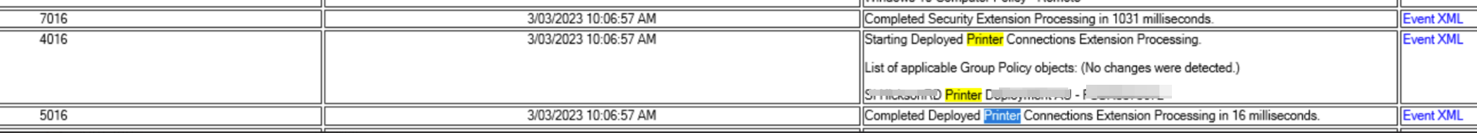

  2. gpupdate /force -> computer group policy successfully gpresult /r -> the group policy was applied. check result from GPO also successful (No changes were detected.
enter image description here
Is the group policy found the same IP address's printer was installed then it thought deployed successfully?
  1. User rebooted the laptop, there is still the printer with the old name. No new printing port or new printer name/printer was added. Just like nothing happened.
What should I do in this scenario? should I uninstall the printer or change the Printers's IP address first , then to deploy?
