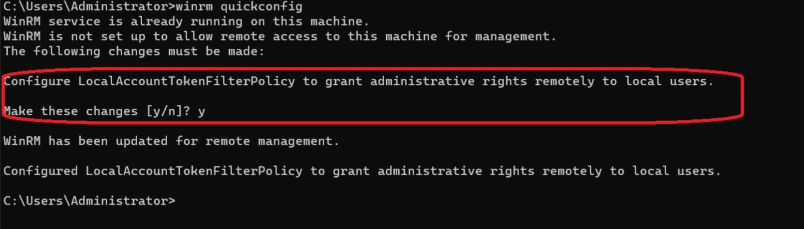

  2. OlekL 0 Reputation points
    2025-06-06T09:05:24.4633333+00:00
    in my case helped this command on Hyper-V nodes before joining to Active Directory
    if I run this command after joining, there wasnt "make these changes" !!!???
