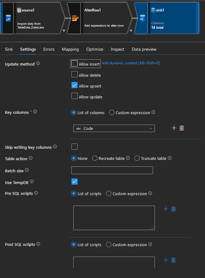

I am trying to load CSV rows from Data Lake into an Azure SQL Database. I use the upsert functionality of the data flow and parameterize it to be able to load the same data into different tables.
this is how i designed my data flow:
grafik
In the alter row activity i set UpsertIf to true() and allowed only upserts in the sink and added the corresponding key columns.
When I run this i get the following error:
Error code: DFExecutorUserError
Failure type: User configuration issue
Details: Job failed due to reason: at Sink 'sink1': ERRORCODE:MSSQL_101, STAGE:INPUT-VALIDATION, MESSAGE:INSERTABLE columns list or UPDATABLE column list or key column list is not properly passed to the stored procedure.
The thing is that in some tables the data is upserted without any problems and in a few tables this issue comes up.
Any suggestions on how to fix it?

    From the screenshot of the dataflow, it's not clear that how are you passing the keycolumn in the sink transformation. Kindly share the full screenshot of the pipeline.

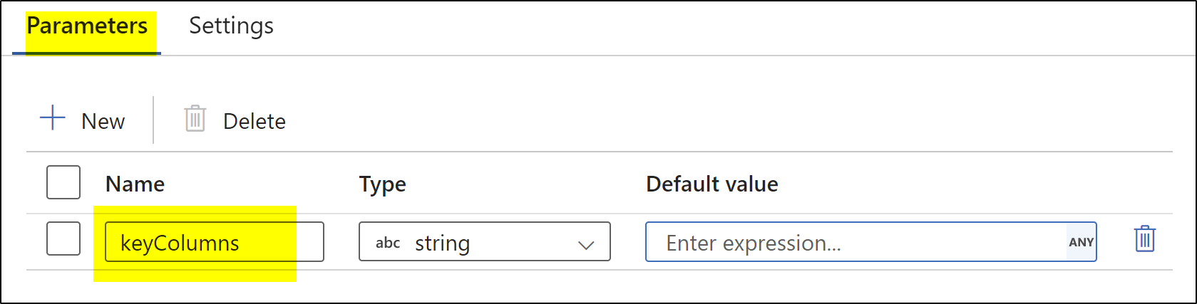

    Since your requirement is to perform upsert for multiple tables while copying data from muliple files, assuming the schema (number of columns , order of columns or columnnames) might be different for different sink tables , it's important to keep two things assured:
    1. Mapping should be dynamic in order to handle multiple table scenario
    2. Key column should be passed dynamically for each of the tables using dataflow parameter. Pass the relevant value for keyColumn via ADF pipeline. User's image
    Relevant resources for point 1: Implement Upsert logic in Mapping data flow
    Hope it helps. For better implementation ,kindly share the screenshot of what you have tried so far. Please let me know in case any further assistance is required. If it helps, kindly accept the answer. Thankyou

  1. Mike Matthews 1 Reputation point
    2023-10-26T18:54:09.59+00:00
    I was seeing this error message when I had two key columns (an int and a guid) specified for my sink. I realised that the int column was not needed to uniquely identify rows, and removing it from the key solved the problem.
