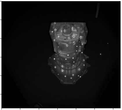

I am currently working on a project which requires to detect reflective targets on objects, and create holograms based on these targets.

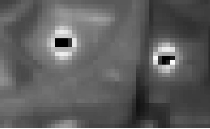

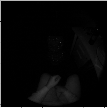

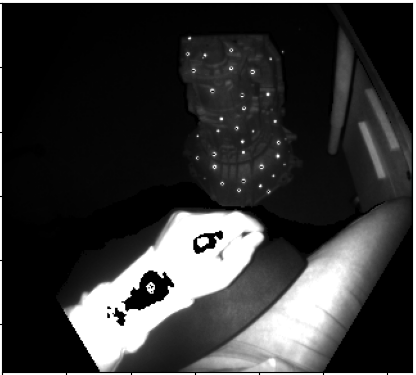

I know I need Research Mode to get access to IR cameras, and I use this github https://github.com/microsoft/HoloLens2ForCV to help. I can get infrared camera pixels and then our image processing algorithms could do the trick.
I don't want to use Unity or any other engine, so I will be using the C++/WinRT (no OpenXR as I need to access Research Mode, only possible with WinRT)
Is this the best way to do this or is there another appropriate way that you could think of ?

    For noise in the IR sensor, have both versions DEPTH_AHAT and DEPTH_LONG_THROW been tried?
