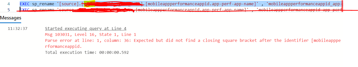

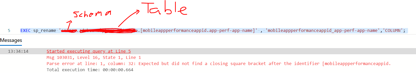

I want to change a column name of a table . But issue is that column name is containing dot in it . which is creating issue while I am executing below statement.:-
I can not drop the table as it contains huge and important data
expecting Column name = mobileappperformanceappid_app-perf-app-name
current column name = mobileappperformanceappid.app-perf-app-name
EXEC sp_rename 'source.tbalename.mobileappperformanceappid.app-perf-app-name' , 'mobileappperformanceappid_app-perf-app-name','COLUMN';

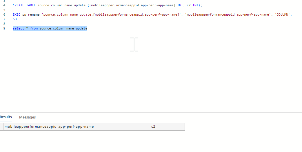

  1. SSingh-MSFT 16,371 Reputation points Moderator
    2023-04-04T12:42:40.71+00:00
    Hi Gulhasan.Siddiquee
    Thanks for trying afresh the queries.
    The problem looks strange, I tried to follow the same naming convention for the schema and tables and could execute commands successfully as shown below: User's image
    The issue in your Azure Data Studio looks strange and not expected. I would recommend you to please file a support ticket for deeper investigation and in case if you don't have a support plan, do let us know here so that we can check on other options to unblock you.

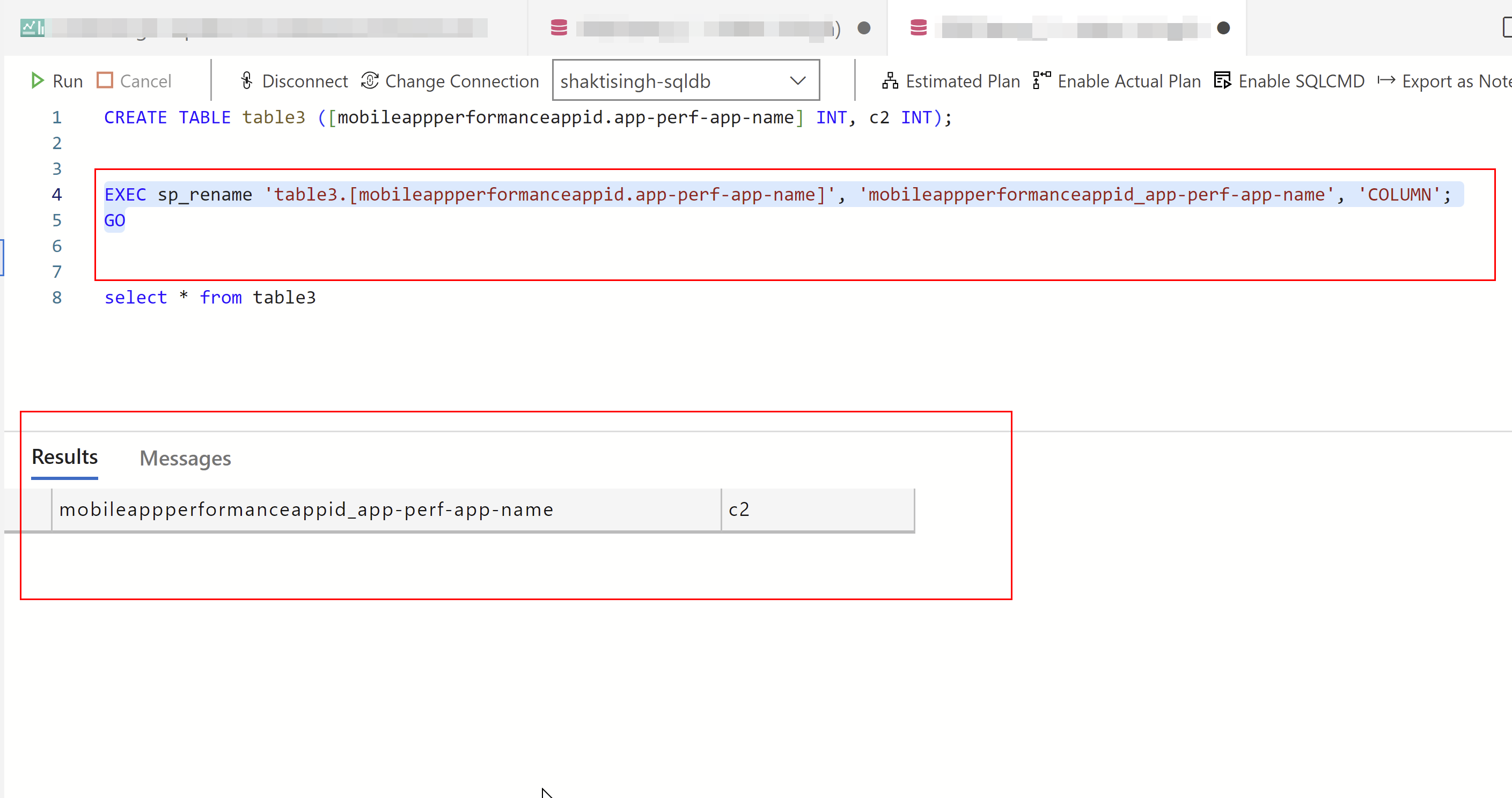

    I have tried to create a dummy table with column name same as mentioned by you in the original question and then tried to rename it using below command and was able to do it successfully:
    EXEC sp_rename 'table3.[mobileappperformanceappid.app-perf-app-name]', 'mobileappperformanceappid_app-perf-app-name', 'COLUMN';
    GO
    Could you please try above and let us know if it works. If not, let me know your table structure so that I may try to reproduce it. Thanks

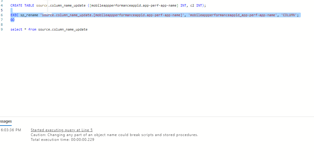

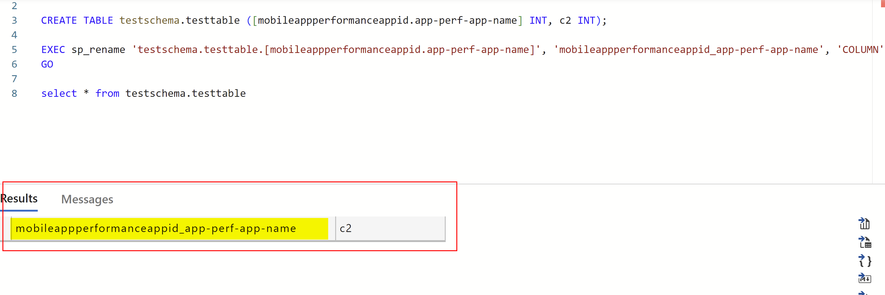

  3. SSingh-MSFT 16,371 Reputation points Moderator
    2023-04-04T06:53:25.3433333+00:00
    Hi Gulhasan.Siddiquee •, Please find below details of the query execution of table inside schema working fine: User's image
    Try to update Azure Data Studio and execute. If not working, kindly try to create a sample table and execute commands to check if the issue is with existing table or with new too. Thank you.
