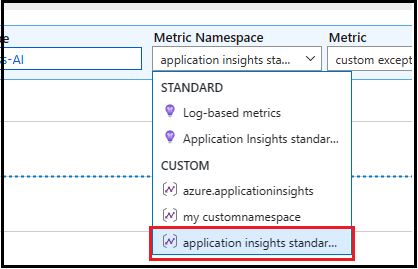

    Note that - even if I have used the exact namespace of the STANDARD category, the metric gets listed under CUSTOM category with this namespace:
