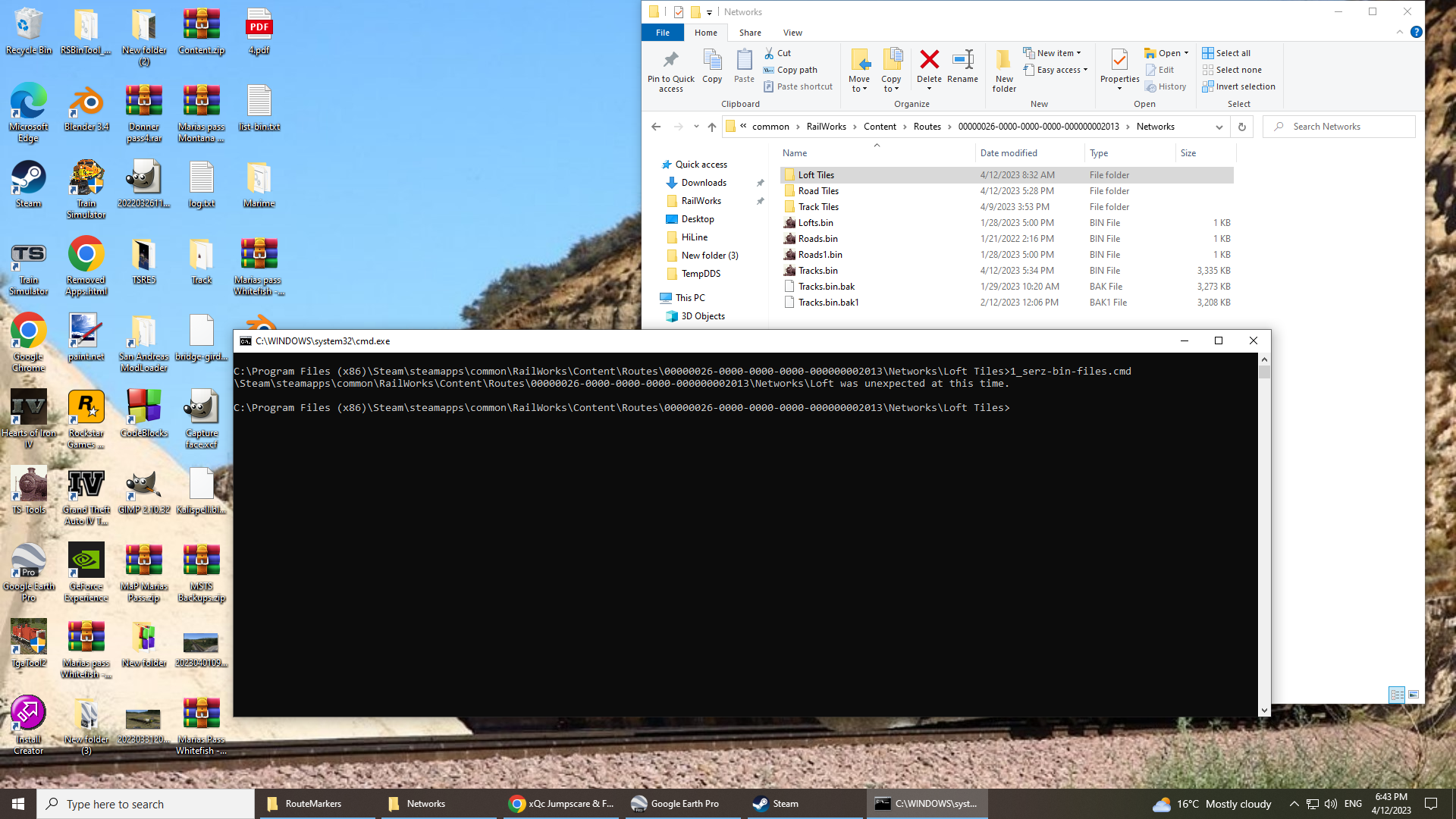

  2. MotoX80 37,781 Reputation points
    2023-04-12T16:32:32.9166667+00:00
    Check the encoding. Edit the cmd file with Notepad and verify that it shows "Windows (CRLF) UTF-8" in the lower right corner of the window. If it's something else use the file saveas dialog to set the encoding. Then from the command prompt, use the TYPE command to display the file contents. Does it look ok?
  3. Lukas Valancauskas 5 Reputation points
    2023-04-12T15:44:38.7566667+00:00
    Here is a picture: Capture
