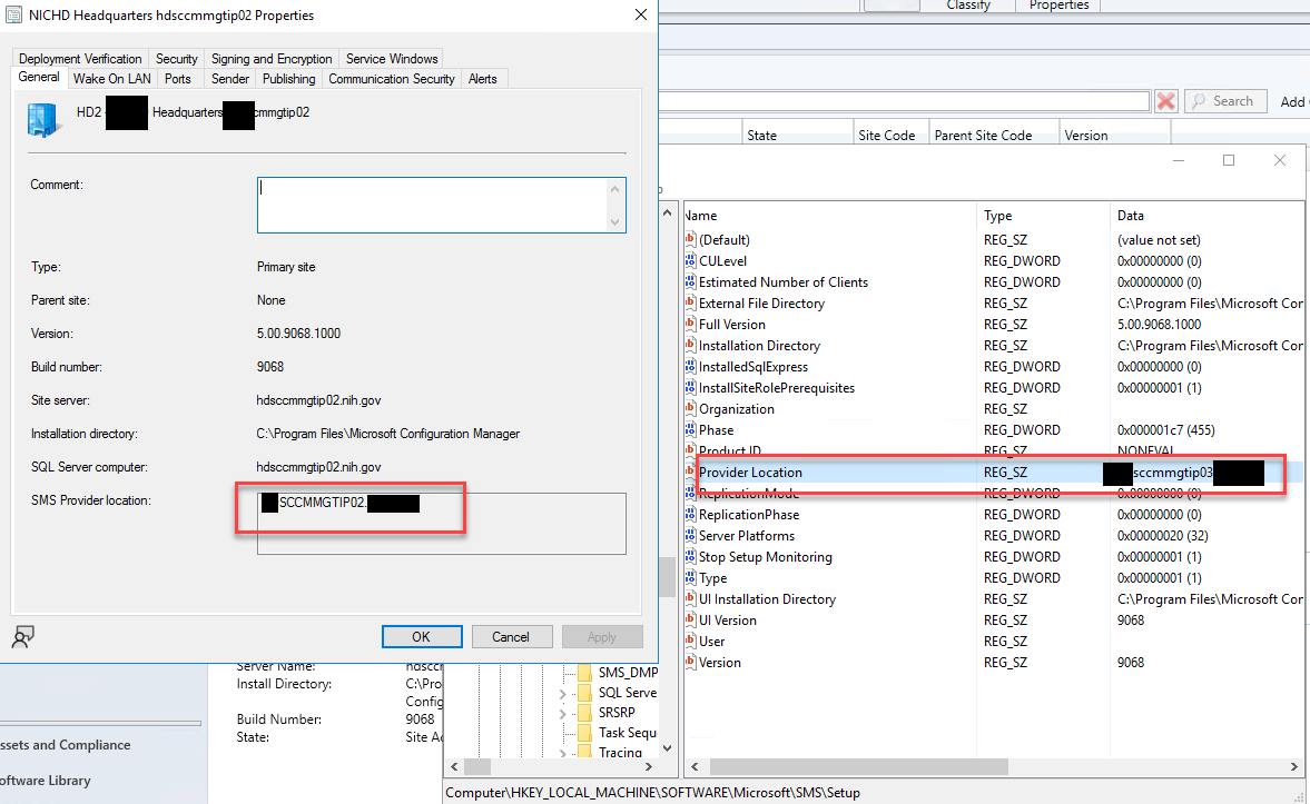

    I'm not sure if this is the root of the issue, but I noticed the SMS provider location in the registry is the server that does not exist. And it is also different from what I see on the console. I'm too hesitant to make any changes.
    Andy advice would be apprectiated

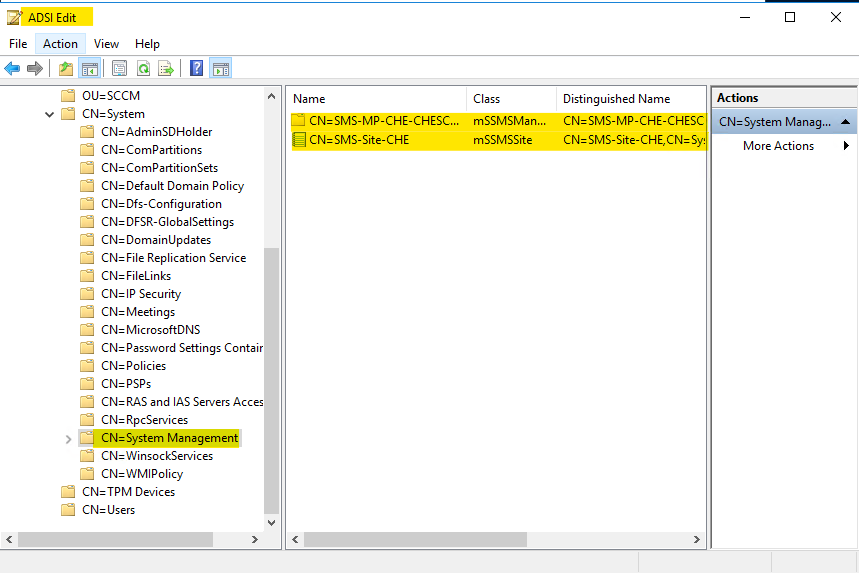

    2, What role did this server play in the environment before that? How did you remove it? Are you using a newly created environment? Have you checked ADSI Edit container and removed it? The screenshot for your reference: 1
    For how to uninstall roles, sites, and hierarchies in Configuration Manager, please refer to this link:
    Uninstall sites - Configuration Manager | Microsoft Learn
