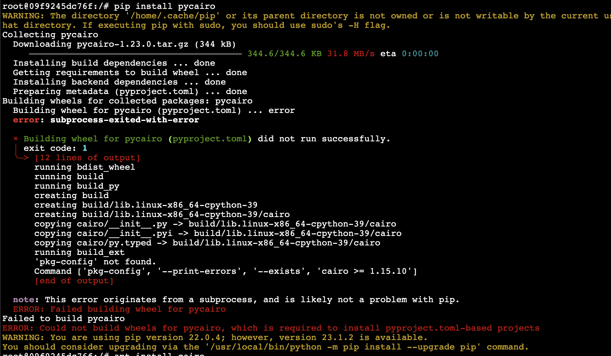

Building wheels for collected packages: pycairo Building wheel for pycairo (pyproject.toml): started Building wheel for pycairo (pyproject.toml): finished with status 'error' error: subprocess-exited-with-error
Building wheel for pycairo (pyproject.toml) did not run successfully. exit code: 1 lines of output] running bdist_wheel running build running build_py creating build creating build/lib.linux-x86_64-cpython-38 creating build/lib.linux-x86_64-cpython-38/cairo copying cairo/init.py -> build/lib.linux-x86_64-cpython-38/cairo copying cairo/init.pyi -> build/lib.linux-x86_64-cpython-38/cairo copying cairo/py.typed -> build/lib.linux-x86_64-cpython-38/cairo running build_ext Package cairo was not found in the pkg-config search path. Perhaps you should add the directory containing `cairo.pc' to the PKG_CONFIG_PATH environment variable No package 'cairo' found Command '['pkg-config', '--print-errors', '--exists', 'cairo >= 1.15.10']' returned non-zero exit status 1. [end of output]
note: This error originates from a subprocess, and is likely not a problem with pip. ERROR: Failed building wheel for pycairo Failed to build pycairo ERROR: Could not build wheels for pycairo, which is required to install pyproject.toml-based projects
The python dependency xhtml2pdf requires the python dependency pycairo which requires the OS-level package cairo. According to the docs on https://pycairo.readthedocs.io/en/latest/getting_started.html, it seems that the container running Oryx Build is missing cairo >= 1.15.10 thus failing.
