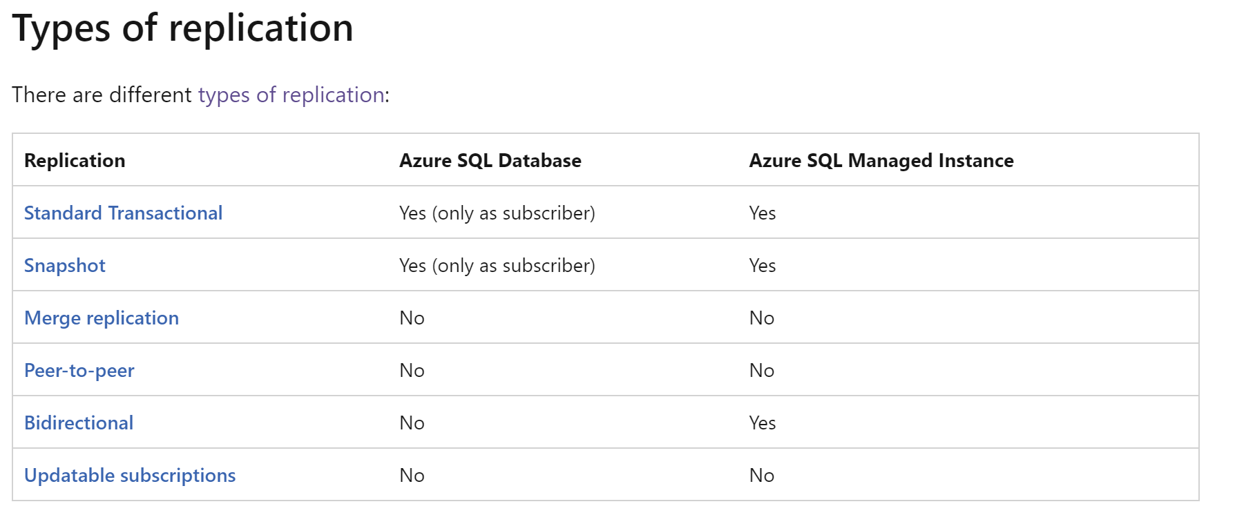

    Regarding transactional replication, The Publisher publishes changes made on some tables (articles) by sending the updates to the Distributor. The publisher can be an Azure SQL Managed Instance or a SQL Server instance.
    The Distributor collects changes in the articles from a Publisher and distributes them to the Subscribers. The Distributor can be either a Azure SQL Managed Instance or a SQL Server instance (any version as long it is equal to or higher than the Publisher version).
    The Subscriber receives changes made on the Publisher. A SQL Server instance and Azure SQL Managed Instance can both be push and pull subscribers, though a pull subscription is not supported when the distributor is an Azure SQL Managed Instance and the subscriber is not. A database in Azure SQL Database can only be a push subscriber.

    When it comes to Transactional Replication and Azure SQL Managed Instance, there are two distinct topologies that are supported:
    1. Published and distributor configured on one or two separate Azure SQL Managed Instances + Subscriber on Azure SQL Managed Instance or Azure SQL Database or SQL Server hosted anywhere, including on-prem or SQL Server on Azure VMs
    2. Publisher and distributor configured on one or two separate SQL Servers hosted anywhere, including on-prem or SQL Server on Azure VMs + Subscriber on Azure SQL Managed Instance.
    So, configurations that you’ve asked about with Pub on SQL Server and Distributor on Azure SQL Managed Instance are NOT supported.
