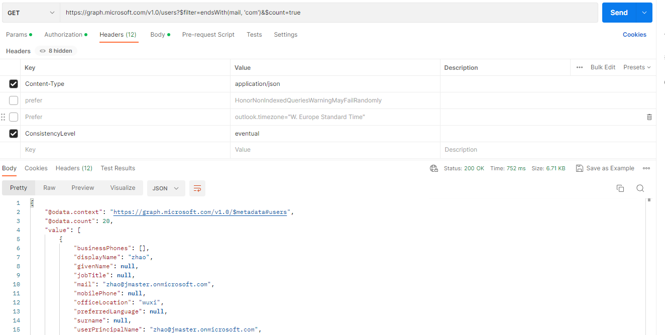

    Hi Pokemon Go , here's what I've tested and worked so far.
    https://graph.microsoft.com/v1.0/users?$filter=mail ne null&$count=true
    ConsistencyLevel: eventual
    https://graph.microsoft.com/v1.0/users?$filter=endsWith(mail, 'com')&$count=true

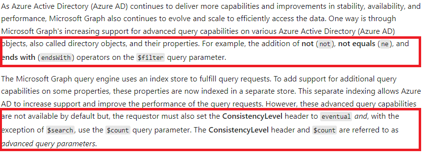

    For ne and endsWith operators, it can be achieved by adding ConsistencyLevel header and $count parameter. Since ne and endsWith operators are all advanced queries, you need to add ConsistencyLevel header and $count parameter.
