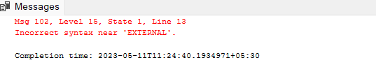

My Requirement is need to read file from Blob Storage and I need to create that file as External table. But I'm using AZURE SQL Server version of 2012. Here I'm unable to install POLYBASE for creating external table.
I just want to know which version of SQL Server is supported for creating or Installing POLYBASE is required. I have followed the instructions for creating external table like:

After this error, i'm trying to check whether polybase is installed or not using below query. then i found it is not available. so now i need to know know which SQL version is supported for polybase.

    The PolyBase feature provides connectivity to the following external data sources:
    • SQL Server 2022 (16.x) does not support Hadoop.
    • SQL Server 2016 (13.x) introduced PolyBase with support for connections to Hadoop and Azure Blob Storage.
    • SQL Server 2019 (15.x) introduced additional connectors, including SQL Server, Oracle, Teradata, and MongoDB.
    • SQL Server 2022 (16.x) introduced the S3-compatible storage connector.
    • SQL Server 2019 (15.x) Cumulative update 19 introduced support for Oracle TNS.
    • SQL Server 2022 (16.x) Cumulative update 2 introduced support for Oracle TNS.
    To use PolyBase in an instance of SQL Server:
    1. Install PolyBase on Windows or Install PolyBase on Linux.
    2. Starting with SQL Server 2019 (15.x), enable PolyBase in sp_configure, if necessary.
    3. Create an external data source.
    4. Create an external table.
    Reference document link: Introducing data virtualization with PolyBase
    PolyBase provides these same functionalities for the following SQL products from Microsoft:
    • SQL Server 2016 (13.x) and later versions (Windows)
    • SQL Server 2019 (15.x) and later versions (Windows and Linux)
    • SQL Server Analytics Platform System (PDW)
    • Azure Synapse Analytics (for dedicated SQL pools)
