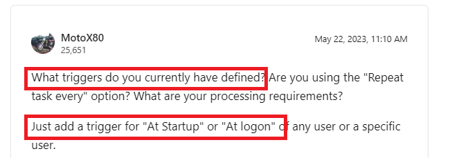

  1. MotoX80 36,406 Reputation points
    2023-05-22T15:10:56.4066667+00:00
    What triggers do you currently have defined? Are you using the "Repeat task every" option? What are your processing requirements?
    Just add a trigger for "At Startup" or "At logon" of any user or a specific user.

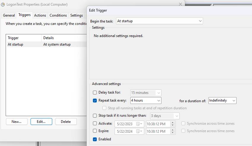

  2. Limitless Technology 44,776 Reputation points
    2023-05-23T11:29:10.8233333+00:00
    Hello
    Thank you for your question and reaching out.
    By entering a time and date in the task's Expire option, you can get around this problem. To access this option, visit the task's Properties, choose the Triggers tab, and then click the Edit button next to the relevant trigger. If the Expire option has a date and time associated with it, the task will try to restart itself if its previous trigger time was missed.

  3. derek chan 1 Reputation point
    2023-05-24T09:22:46.11+00:00
    If the Expire option has a date and time associated with it <<== No , only send if the task run over 1 hour , then expiry , not set date and time .
    is there other possibly reason that casus the error I encounter , thanks advise .
