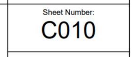

I have a presentation of which I want to print specific slides to a single pdf file. Manually printing using "Microsoft print to PDF" gives perfect result.
The presentation however consists of about 72 sheets (36 pairs) I want to print regularly. Presentation contains set of 2 sheets of drawings per sample I want to create a document per sample type containing both sheets. Doing this manually is super repetitive, tedious and I am bound to make mistakes.
When I try to print using VBA code using ActivePresentation.ExportAsFixedFormat the result is significantly of poorer quality, very blurry. Manually printing 2 sheets gives a pdf file of about 1200 kb and the vba of the same 2 sheets Export is just 300 kb.
Attached detail showing the difference
