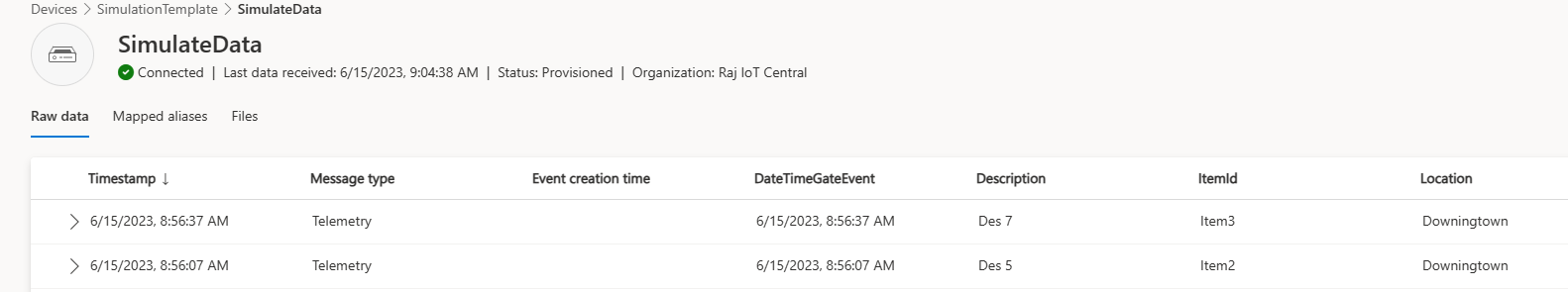

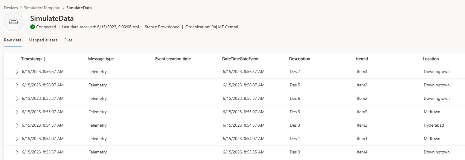

    Please replace the ModelId, DeviceId, DeviceSymmetricKey, hostname in the code with the appropriate values. Note that the easiest way to obtain the hostname is by putting a break point on the line 165 in Program.cs file of TemperatureController project DeviceClient deviceClient = DeviceClient.Create(hostname, authenticationMethod, TransportType.Mqtt, options);
    Running this code would simulate the data on to IoT Central without any issues. Please refer the following image.
    enter image description here
    Hope this helps. Please let us know if you have any additional questions or need further assistance.
