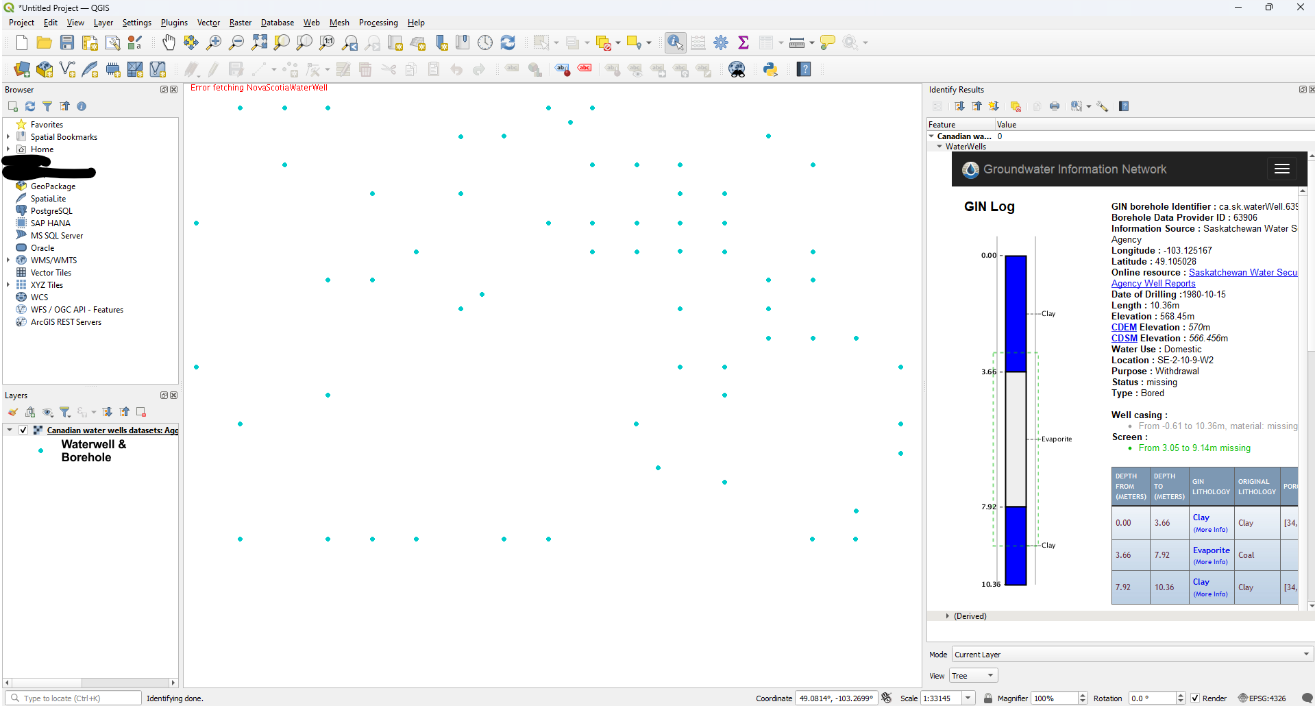

I tried loading the same WMS service on QGIS software and there seems to be features available in this WMS service. I've attached a screenshot of the features loaded for WaterWells sublayer from the url.
