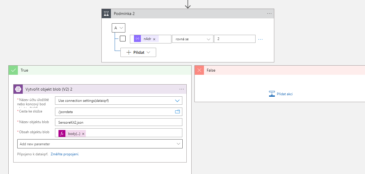

    2023-06-19T10:07:29.09+00:00
    I'm trying to store the entire JSON message in blob storage. But the messages are sent from two sensors, so I want to split them by nAdr into two different blob storage.
    Here are screenshots of my attempt to build a logic app:
