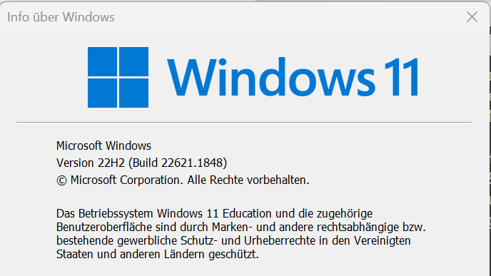

We have been having problems with Windows 11 22H2 and Bitlocker since March 2023. With the latest update from June the problem is still there.
WinVer

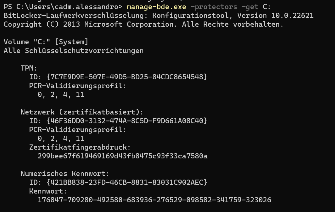

We install our devices with MEMCM, all devices are encrypted with Bitlocker but with different settings.
The Administration devices are encrypted with Bitlocker PIN and the recovery key is stored in the AD, we also use Bitlocker network unlock.

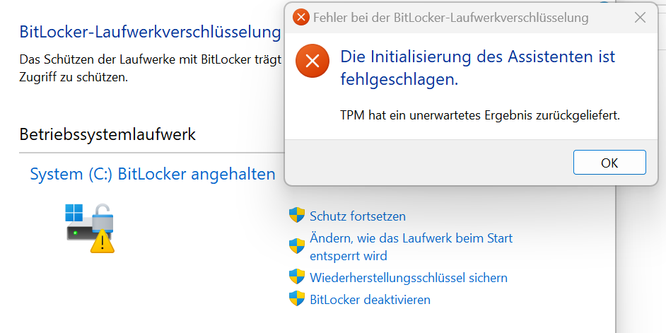

The Windows 11 22H2 Administration device is encrypted, but as soon as we apply the GPO for Bitlocker Network Unlock on the device and Bitlocker for Update is stopped, we get the following error messageResume_Bitlocker

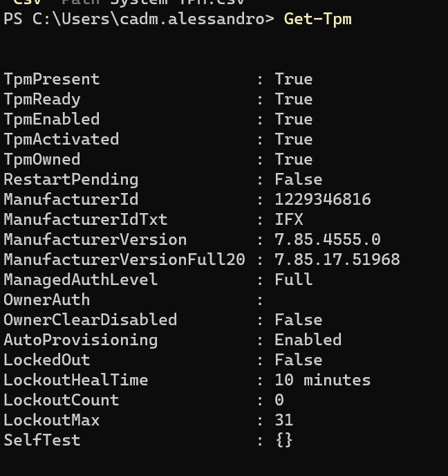

Does anyone have any ideas? Please find attached the TPM and Bitlocker log files.

TPM_Info
Manage-BDE

Resume_Bitlocker.txt
