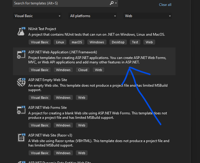

    So, create a new project, vb.net, asp.net, .net framework.
    This project choice:

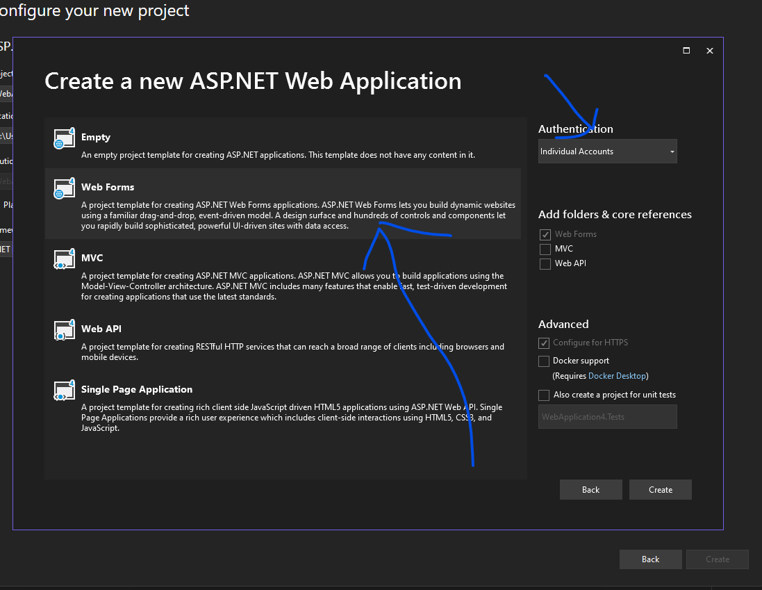

    And then to have the "logon" data base created for you, then after above, choose this option:
    So, above will create a database, and the database follows VERY much and close to how the previous FBA (logon database) worked.

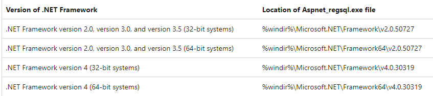

    aspnet_regsql is currently available. Aspnet_regsql.exe is installed in the Microsoft.NET Framework directory.
