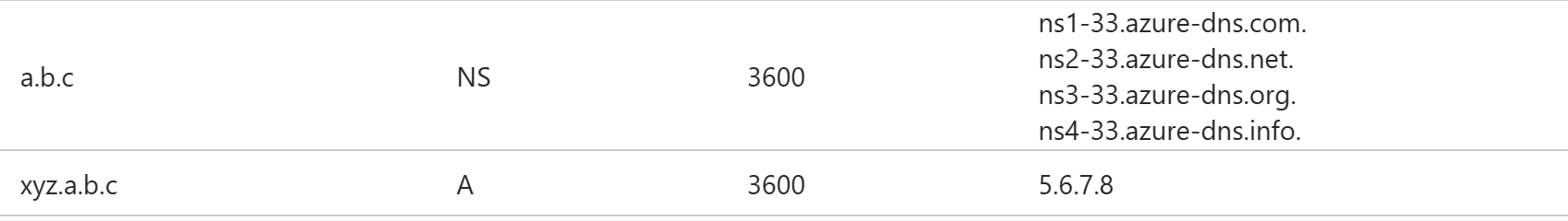

I'm able to add the following example in Azure DNS:
parent zone: mycompany.ca
a.b.c.mycompany.com NS azure1.dns.co,
child zone: a.b.c.mycompany.com
There are no b.c.mycompany.com nor c.mycompany.ca zones
I'm just wondering if this is what is causing this alert:
Status: Degraded
Last update: Current DNS zone contains one or more delegation records for child DNS zone. However, this DNS zone also contains records below delegation record that should only be present in the child zone. Please remove or move the delegated records (except glue records)
I don't see A records in the parent domain that should be in the child domain.

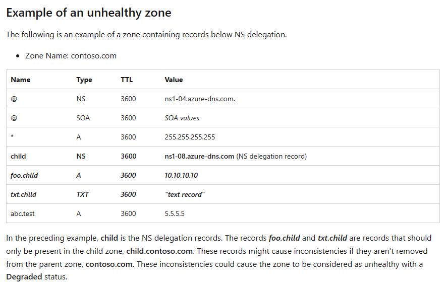

    I understand you received an alert for Azure DNS as following "Status: Degraded : Current DNS zone contains one or more delegation records for child DNS zone. However, this DNS zone also contains records below delegation record that should only be present in the child zone. Please remove or move the delegated records (except glue records)".
    A Degraded status indicates that the resource health check has detected a delegation issue with your DNS zones. Correct the delegation configuration and wait 24 hours for the status to change to Available.
    You can find more details about this issue in the below troubleshooting guide:
    https://learn.microsoft.com/en-us/azure/dns/dns-troubleshoot#degraded
    In the above troubleshooting guide, you can find an example of an unhealthy zone with inconsistencies that could cause the zone to be in Degraded status.
    How can you fix it? - To resolve, locate and remove all records except glue records under NS delegation records in your parent zone.

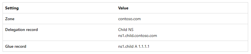

    What are glue records? - These are records under the delegation record, which help direct traffic to the delegated/child zones using their IP addresses and are configured as seen in the following:
