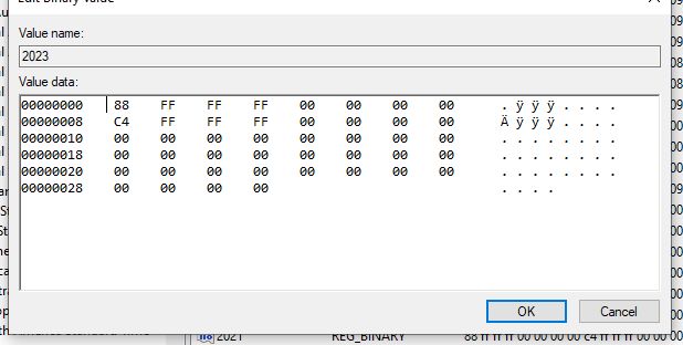

This update depends on other updates that will make the pcs too slow, so we create a policy group was created to clone the registry files that are responsible for updating Egypt Time Zone and Dynamic DST from the domain to Clint PCs for a week till all PCs are updated by GP, It is confirmed that the recording files in the domain related to Time Zone Egypt and Dynamic DST have been copied and updated on the devices within that domain
but occasionally some PCs return to their old status and cancel the daylight option and switch it to OFF !!
After returning to Regedit and following the paths of the change, I found that a change had been made in:
Computer\HKEY_LOCAL_MACHINE\SOFTWARE\Microsoft\Windows NT\CurrentVersion\Time Zones\Egypt Standard Time\Dynamic DST\2023 with different value from domain
the value of 2023 must be : (check the first image to see the different )
"2023"=hex:88,ff,ff,ff,00,00,00,00,c4,ff,ff,ff,00,00,0a,00,04,00,05,00,17,00,\
  3b,00,3b,00,e7,03,00,00,04,00,04,00,05,00,17,00,3b,00,3b,00,e7,03
