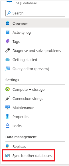

Hi Folks,
We have 2x Azure Managed SQL Databases - both in the same instance.
DB-A (Production)
DB-B (Development / test)
I am attempting to use a Databse Sync group to replicate the content from DB-A to DB-B for testing.
As DBA-A has over 500 tables I've already created the appropriate differing log in / user and set permissions to that it can only "see" 491 of the tables - All good there.
Challenge comes with I run the Sync group - the following errors are producted in the log
I've already
  • Reconfirmed login details for both DBs (inc re-enterting)
  • Re-set up Data sync
  • Made associated DB user sys-adm on both DB-A and DB-B
DB-A
Database provisioning failed with the exception "SqlException ID: fbf8435a-fee6-4804-afc6-272aa45ac120, Error Code: -2146232060 - SqlError Number:15247, Message: User does not have permission to perform this action. SqlError Number:2759, Message: CREATE SCHEMA failed due to previous errors. For more information, provide tracing ID ‘8f643c97-db2c-4b54-ad56-5cd68df7ab44’ to customer support."
DB-B
Database provisioning failed with the exception "SqlException ID: 9fc7d19a-a48f-4c89-bac6-4cc77b21ecf0, Error Code: -2146232060 - SqlError Number:15247, Message: User does not have permission to perform this action. SqlError Number:2759, Message: CREATE SCHEMA failed due to previous errors. For more information, provide tracing ID ‘f4edbcc7-5b7e-4685-8082-c2d20b9dd500’ to customer support."
My SQL knowledge is very basic so appreciate any insight
Many thanks :)
