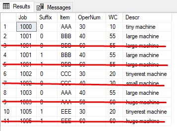

  3. Lance James 371 Reputation points
    2023-07-19T20:36:18.3+00:00
    Additional information regarding my OP.
    Here is a basic query that gets close but returns too many rows. Only a single row should return where Job and Suffix match.
    SELECT A.Job, A.Suffix, A.Item, B.OperNum, B.WC, C.Descr
    FROM A
    LEFT JOIN B ON A.Job = B.Job
    LEFT JOIN C ON B.WC = C.WC
    WHERE A.Release = 'R' And B.Comp = 0
    ORDER BY A.Job, A.Suffix, A.Item, B.OperNum;
    Here is the output. I struck the wrong lines.
    Thanks,
    Lance
