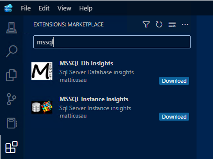

Hence I wanted to install this extension :mssql
I looked in available list but I don't see it listed there.
What I'm doing wrong? Note: I don't have admin privileges for the server and it's controlled by my organization ..

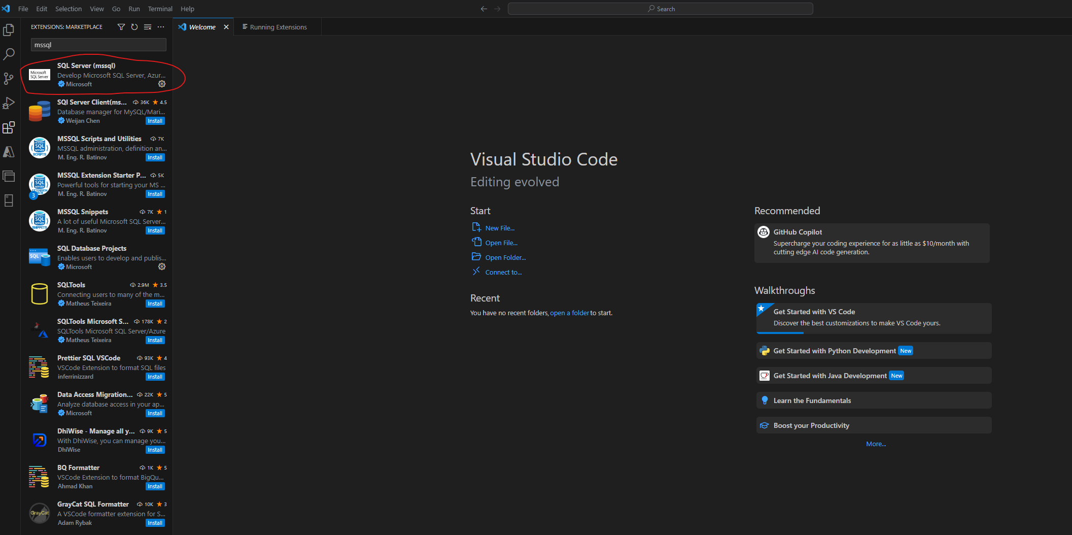

  1. Oury Ba-MSFT 20,931 Reputation points Microsoft Employee Moderator
    2023-07-31T17:14:53.4533333+00:00
    Susja
    Azure Data Studio has the mssql extension essentially bundled into it (and that's what makes ADS a primary provider of mssql functionality).  You don't need to download it. It is already installed by default.
    You were not able to see it in ADS because it is not an extension for ADS, it is for VS code, to provide mssql functionality.
    VS Code and ADS are two different tools entirely.
    I am mostly will use it for MS SQL related things. like writing queries and etc.
    Hence, I wanted to install this extension :mssql
    You can do it in ADS.
    2023-07-25T16:27:58.9466667+00:00
    @Susja Thank you for reaching out.
    My understanding is that you are not able to install mssql extension in Azure Data Studio.
    Supported operating systems.
    The mssql extension for VS Code is supported on Windows, macOS, and Linux. The following versions are supported:
    • Windows: 7 (with SP1), 8, 8.1, 10, 11
    • Windows Server: 2016, 2019, 2022
    • macOS: 10.12+, 11, 12
    • Linux: Debian 9+, RHEL 7+, Ubuntu 18.04+
    review this mssql extension for Visual Studio Code
    I would suggest reviewing the doc info above which contains step by step and all the system requirement needed when install mssql extesion.
