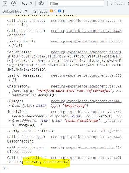

Suddenly we are getting into an issue - the meeting gets disconnected with the code 410 and 3112. There are no exceptions thrown.
Screen print of the console for your reference is

	      console.log(`Call ended, call end reason=			{code=${call.callEndReason.code}, subCode=${call.callEndReason.subCode}}`);

    I have looked at the backend logs for above shared specific call id and we see that call got disconnected due to MediaWhitelistingIssue/410.0/3112.0 issue,
    As mentioned in the documentation Prepare your organization network for Azure Communication service make sure that you have configured your organization firewall by whitelisting the mentioned IP's.
    If you are still facing the issue, I would suggest you raise support ticket to Azure communication service team to check and assist you further.
