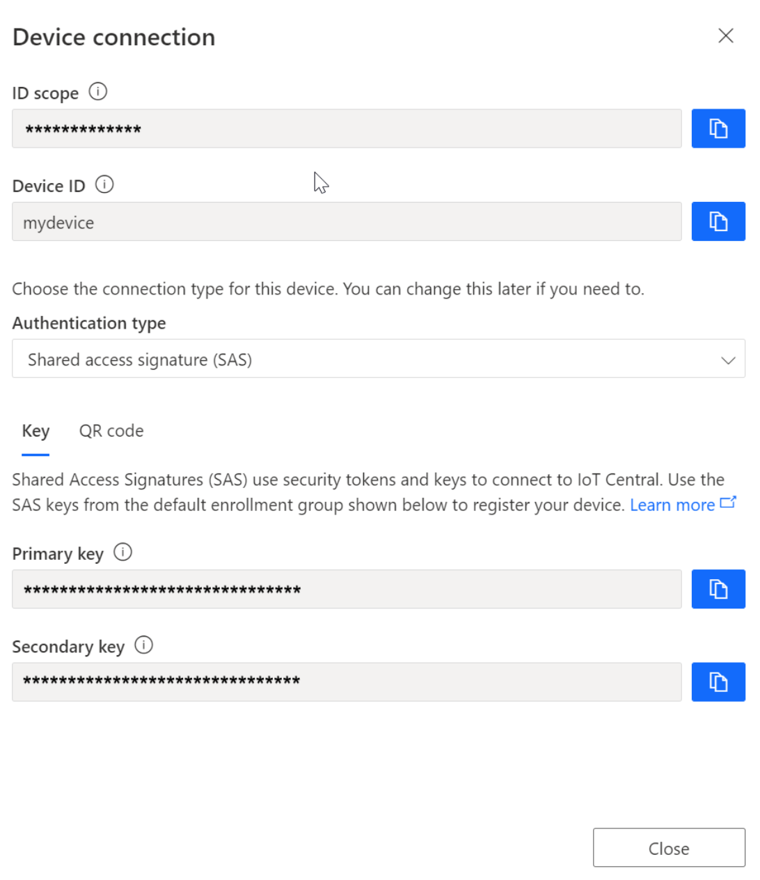

    The answer to this question lies in the Prepare the device section of the Tutorial you have mentioned in your question. Once you created an IoT Central Application and added a device following the steps outlined in the article, you would be able to capture the credentials needed for establishing a connection to this device. Step 7 of the Create a new device section shows the details need to configure the connection with your SMT32 device. Please refer the below image for reference.
    Once you capture the ID scope, Device ID and the Primary Key details, you can provide them in the getting-started\STMicroelectronics\B-L475E-IOT01A\app\azure_config.h file. The SDK will utilize these settings from the code through STMicroelectronics/B-L475E-IOT01A/app/nx_client.c and establish the connection to the device.
