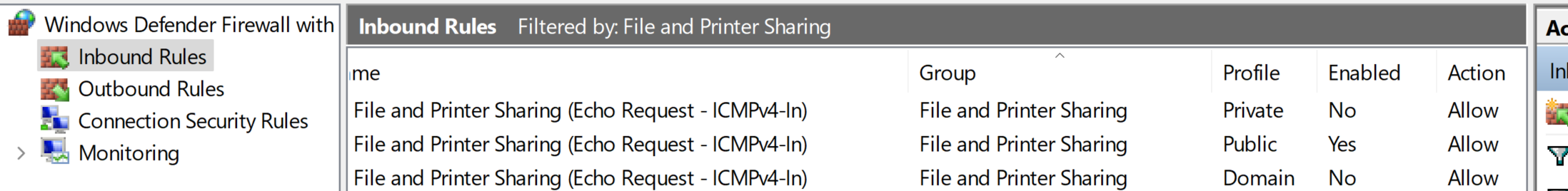

    Are the hosts side-by-side or on opposite sides of the earth? Wondering about the route between vSwitches. I'd check that both got the domain network profile. ICMPv4 firewall rule is not enabled by default unless the domain profile is in use.
    When NLA starts to detect the network location, the machine will contact a domain controller via port 389. If this detection is successful, it will get the domain firewall profile (allowing for correct ports) and we cannot change the network location profile.
    If the domain was not found or process failed, NLA will let you to determine which firewall profile will be used, private or public, likely defaulting to Public
