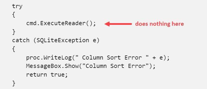

I am processing and sending data base files (db3). I attach two methods which do not function the way I expect them to do as well as the file I am using to test these function. The db3 file is sent as a csv file. Am running Win 11, Visual Studio 2022, using c# and SQLite.
If I run the two methods sequentially the SortColAscending first, the sort does not work (nothing in the file is changed) and, when the DoFileRowID is run, it fails on the execution of the set rowID to 0 saying the database is locked.
If the DoFileRowID is run by itself, the set row ID to 0 works but the Set row ID = ROWID fails like the sort in that nothing in the file is changed.
I have tried changing everything to use "using" hoping it might at least solve the lock problem, but there is no change.
I do have other SQLite methods that are working fine.

            cmd.CommandText = "UPDATE " + table + " SET RowID = 0 ";
            try
                cmd.ExecuteReader();

            cmd.CommandText = "SELECT * FROM " + table + " ORDER BY " + col + " ASC ";
            try

  1. Karen Payne MVP 35,586 Reputation points Volunteer Moderator
    2023-08-04T14:48:31.0833333+00:00
    DoFileRowID and SortColAscending returns seem to be backwards.
    A1
    Also you are invoking ExecuteReader but using it.
    A2
