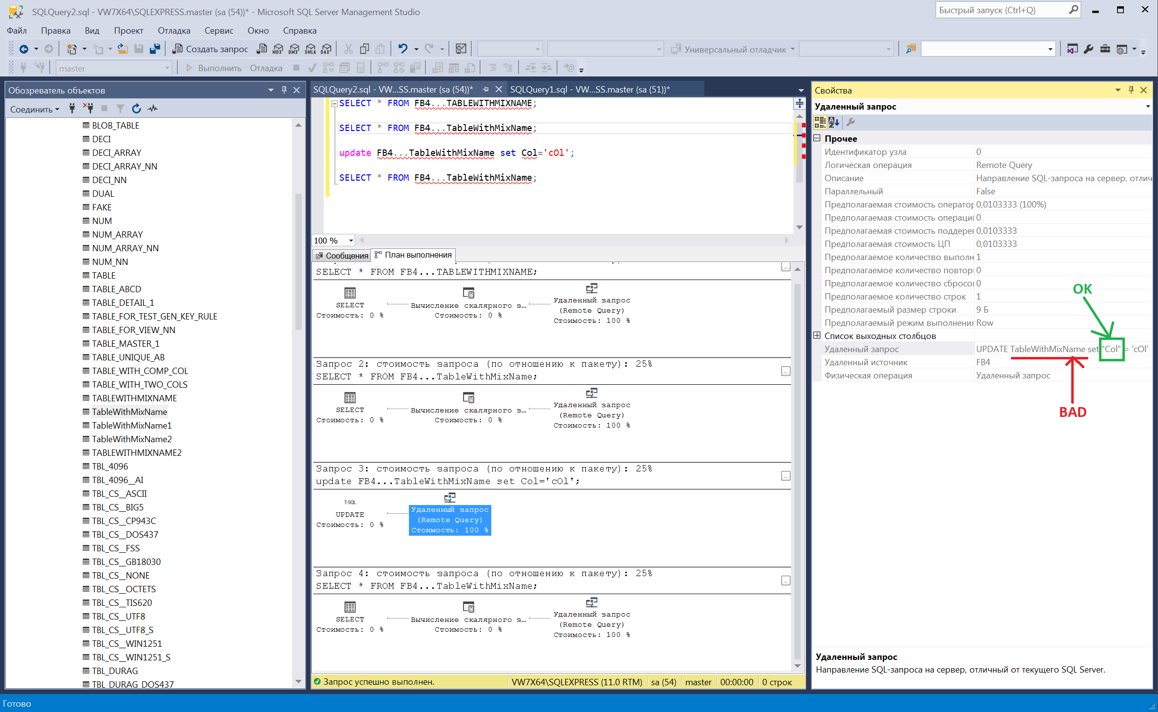

In short - MSSQL does not quote table name in generated UPDATE statement for linked server.
See attached image.
Server generates statement UPDATE TableWithMixName set "Col" = 'cOl_333'
Column name was quoted. Table name - no.
The correct statement is UPDATE "TableWithMixName" set "Col" = 'cOl_333'
2023_08_04--100-mssql-01--bad_update_stmt

  1. Erland Sommarskog 121.4K Reputation points MVP Volunteer Moderator
    2023-08-04T21:40:46.21+00:00
    For what it's worth, when I run (on SQL 2008):
    UPDATE AGGE2.Northgale_utf8.dbo.Orders
    SET    CustomerID = 'ALFKI'
    WHERE  OrderID = 11100
    And then use Profiler to see what happens on the other side, I see:
    declare @p1 int
    set @p1=6
    exec sp_prepexec @p1 output,NULL,N'UPDATE "Northgale_utf8"."dbo"."Orders" set "CustomerID" = N''ALFKI''  WHERE "OrderID"=(11100)'
    select @p1
    That is, quotes are applied.
    If this does not happen in your case, it may be that the OLE DB provider you are using says that it does not support quoted identifiers with UPDATE.
