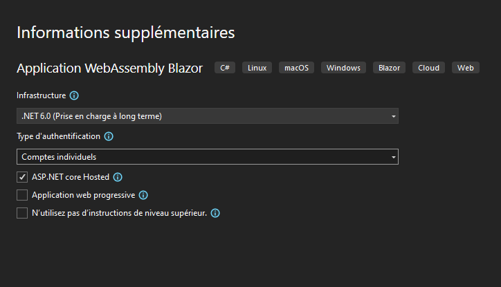

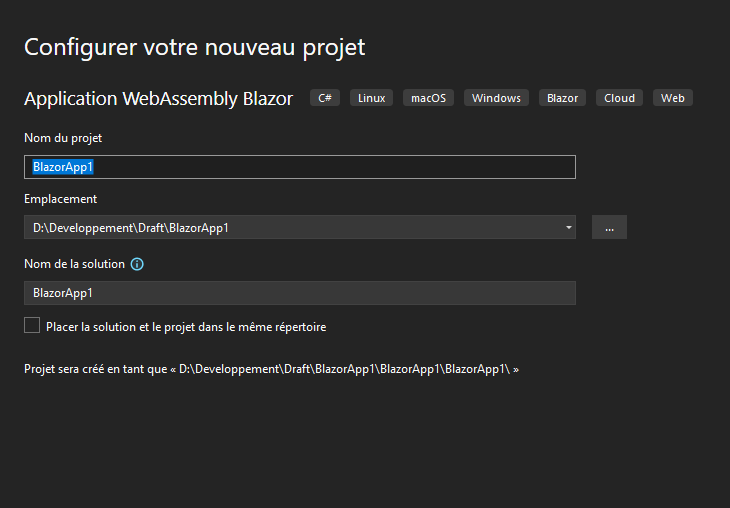

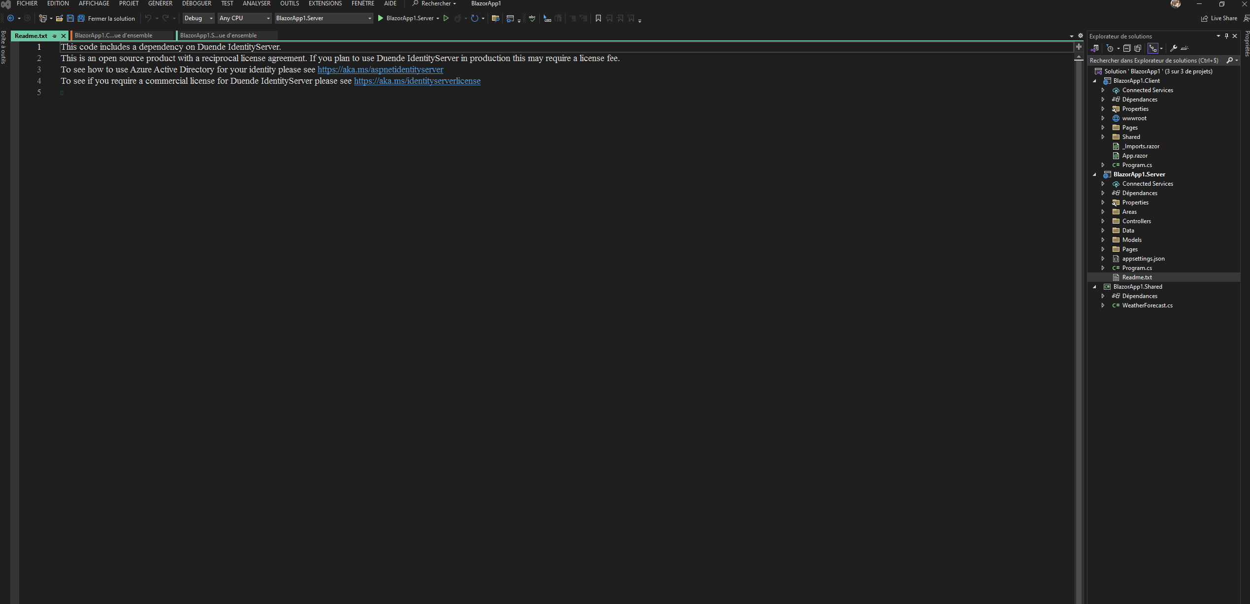

    I always used to create my projects like this:
    (Sorry, my Visual Studio is in French - I'm French, by the way; thanks to ChatGPT for correcting my uncertain English.)
    Capture d'écran 2023-08-23 155457
    Then:
    Capture d'écran 2023-08-23 155651
    Then click the create button, and the result is:
    I use VS 2022 Community. However, it seems that there is an update, as this package wasn't included in the solution when I started using VS2022-C.
