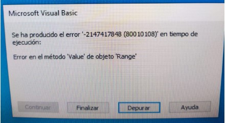

  1. Run-time error '-2147417848 (800 10 108)' occurred: Error in method 'Value' of object 'Range' This is the most common error that I get.
Error 1

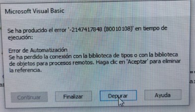

  1. Runtime error '-2147417848 (800 10 108)' occurred: Automation Error. Lost connection to type library or object library for remote processes. Click 'OK' to Remove the reference. I have only had this error twice. It says that I have to click the 'OK' button but I only got the buttons: 'Continue' (which is disabled), 'Finish', 'Debug' and 'Help'. On the first occasion, I didn't have time to click on anything because Excel closed, and on the second time, I clicked on Debug, and then Excel closed.
Error 1
