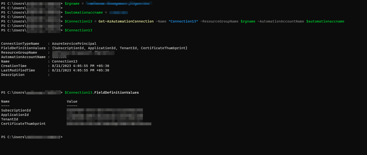

$ErrorActionPreference = "Stop"
$rgname = "RG Name"
$automationaccname = "Automation Account Name"
$vstsConnection = Get-AzAutomationConnection -Name "vstsConnection" -ResourceGroupName $rgname -AutomationAccountName $automationaccname
Write-Output "VstsConnection: $VstsConnection"

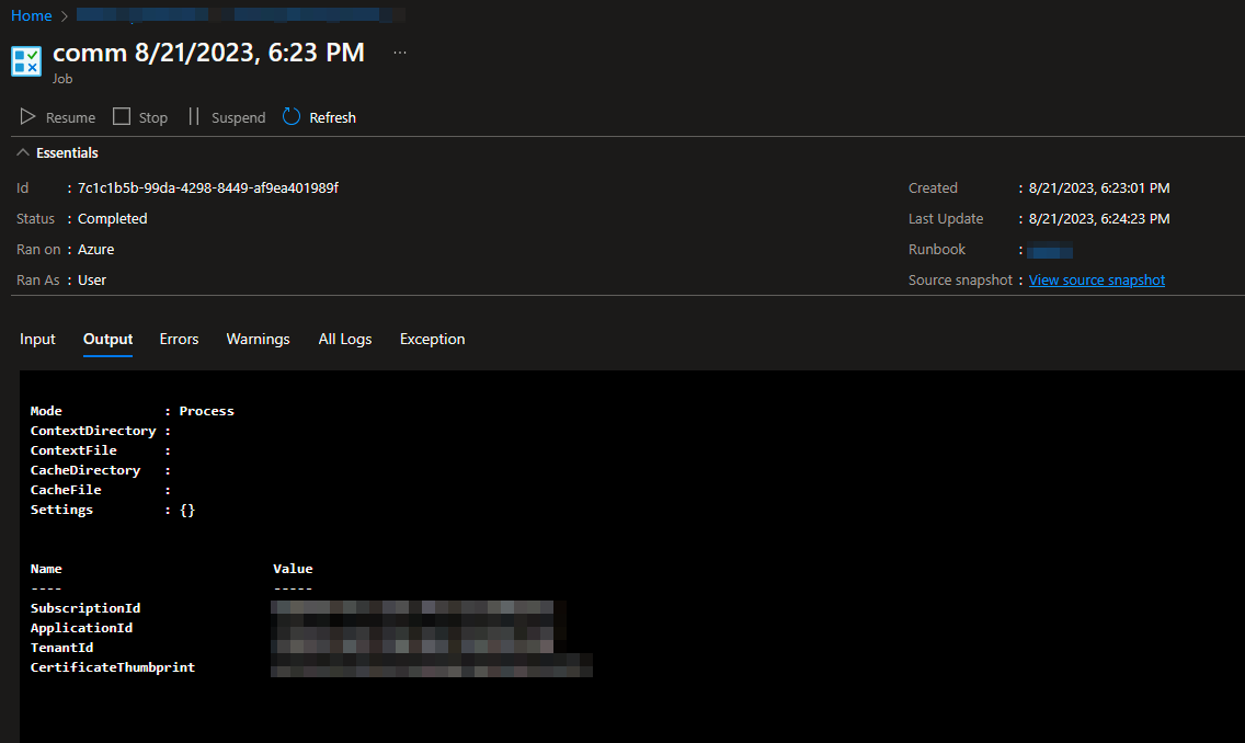

    The West Central US region is one of the early regions where a change is being made to run cloud jobs on Containers instead of Sandbox that automation jobs used to run.
    The role out of this change was gradual, so some jobs run on Sandbox and others on containers. I found that all the jobs that run on a sandbox complete successfully and the ones that run on containers fail. This explains the intermittent failures that you observed.
