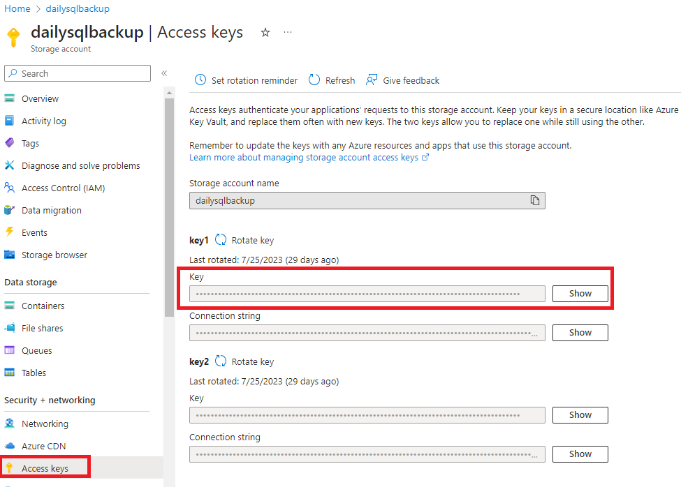

    Can you kindly check if you have copied the storage account key correctly?

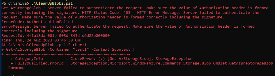

    I just tried the same script to simulate your issue by providing invalid storage account key:
    Once I gave the correct key , the script went through fine...
    Try to regenerate the storage key or use secondary key...
