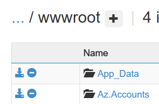

    • The above error occurred since by default the Azure PowerShell (Az) Cmdlets modules won't be available/installed on the app service worker instance.
    • Also, you won't be able to install the required PowerShell module since installation required to change the execution policy which needs admin privilege.
    Alternatively, to fulfill your requirement you can upload the required PowerShell modules to app service from local machine by creating a folder under (site\wwwroot) as shown below.
    and thereby using the below cmdlet to point your web job script to those PowerShell modules.
    Command : $Env:PSModulePath = $Env:PSModulePath+";C:\home\site\wwwroot"
