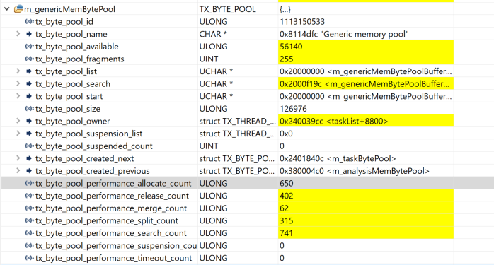

This  is the screenshot of the pool when the hard fault happens. byte pool available is still more than 50k

Now my question is why? Clearly, I have enough available bytes in the pool. You can also see below that the memory required is only 256 bytes. Even if the memory gets fragmented, I am pretty confident there is a block with 256 bytes free on it. Besides, ThreadX is supposed to merge those splits or fragments. Which is also stated in the pool above (tx_byte_pool_performance_merge_count)
